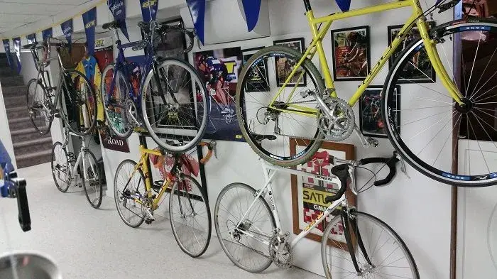

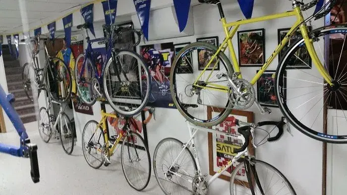

Got a foot of snow this week so back to the trainer now.
