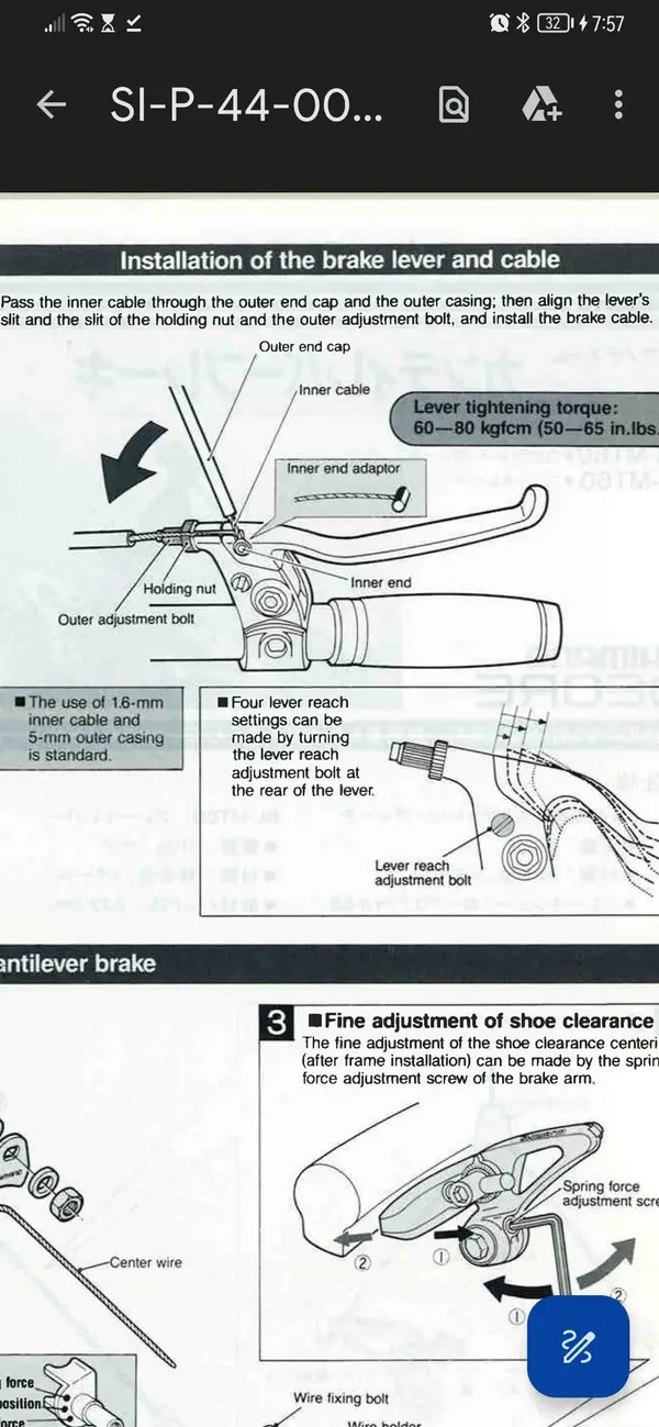

I run a 1991 cinder cone with XT shifters and rear mech, and Deore II brake levers with XTR cantilevers.
My current cables are Jagwire , but I am not sure the brake inner cables are up to the job. The metal ‘ends’ in the brake lever keep twisting around.
Should I order Shimano or are there other options that work well?

Nipples were bigger (motorbike size) bitd. New cables just want an adapter as fluffy says....they come in plastic and brass.
Or buy fat cables....but you will need the outers to match. But xt fat looks better and the cable ferrules actually fill the adjuster too...not flopping about.
That can be fixed by putting a motorbike ferrule over a bike one!

I'm trying to find a link to buy such an adapter - can anyone provide a link or other means to buy one?
