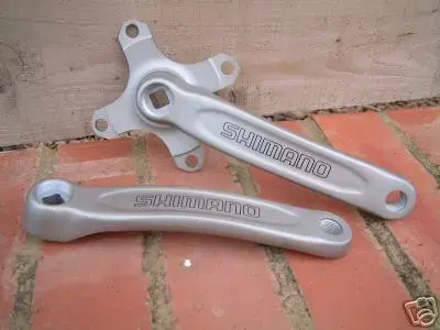

Shimano Mountain Bike Crankset.
Square Taper BB fitment (Ideally suited to a 113mm bottom bracket).
Crank length - 170mm.
CNC Machined alloy spider.
Suits 4 bolt chainrings (104bcd).
Can be used with a single, two or three ring setup.
Colour - Satin Silver (as pic).
These is the cranks I wish to buy.

Guy, I have to say I don't like the look of those cranks for a classic Dome anyway, but quite apart from anything else 170mm crank arms are for people with short legs - say up to 5-4 or so. The standard length is 175mm and it does make a difference. If anything, somebody with a size 20 bike should be thinking about 180mm, especially if single-speeding is a possibility. It's just that 180s are quite hard to find secondhand that's all, and quite expensive new, but I certainly wouldn't advise you to buy 170s.
the only cool 4 arm crankset. i've just got done attacking a set with a can of brasso. results were excellent.
