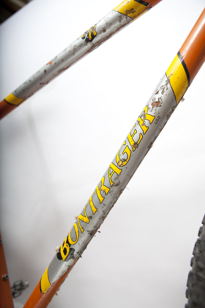

The decals are in rough shape. Really about the most eye-sore part of the bike. I plan on replacing them in the fairly near future, from Gil of coarse. The paint on this bike seems to be quite thick. There are several nicks and gouges in the paint but none seem to be too heinous. I figure when I strip the decals for replacement I will be able to give the paint a nice buff and polish. Should look sharp when I'm through.

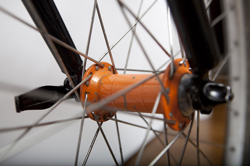

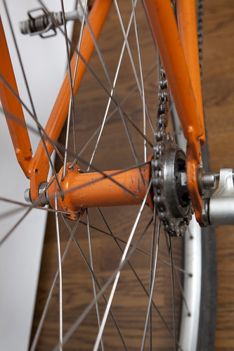

The wheelset is Mavic X138 rims laced to Paul single speed hubs painted orange for the Bianchi B.O.S.S. from some years ago. The color of the paint matches almost perfectly. I (edit)have on order(edit) a White Industries Eno rear wheel in order to make it run smoothly without having to use the singulator. I currently (edit)have(edit) a White Industries Duo freewheel with a 17and 19 tooth cog. I am very taken with the WI parts, well made and beautiful.

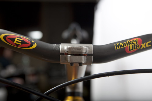

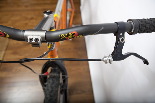

Here in the front I have the most recent set up. Easton Monkey lite carbon and a thing of elegant beauty, the Moots ti stem. Add the Love levers and we are cookin'.
Finally here in the rear attached to the XTR V is one of those roller thingies that I have no idea who made it. Any one know? Just to round out the list if you've read this far, I have a gel ti Flite and a selection of seat posts. Currently with a newer Ringle post, I have a polished Bontrager post and a Syncros post ready to crack and set me on my ass.

That Moots stem is beautiful 8)
