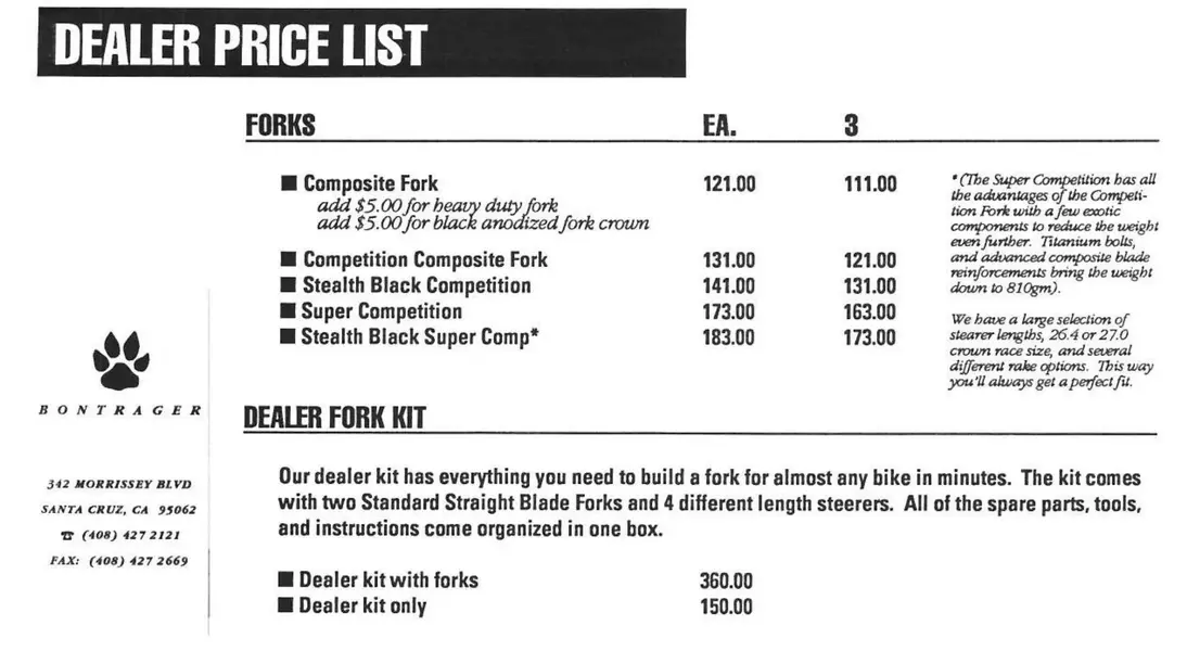

Though there are a ton of variants over the years (ie curved/straight legs, different blade gauges, different drops, canti/rollercam/ubrake mounts, suspension corrected etc) the competition fork that is on my '90 OR, as I found it, measures 395mm AC. I think some people measure theirs at 390mm like pw & slack. I do know the forks around that time were offered with 3 different rakes 1.25" 1.5" and 1.75"
Some of the fork stuff here below, first 4 snips are from the 1990 docs I have .
