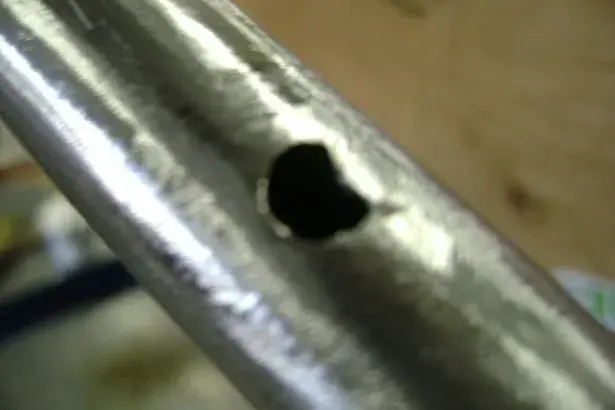

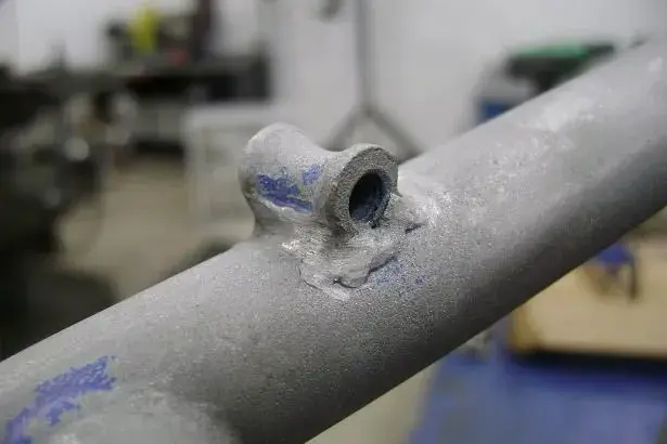

Bob's Yo came to me after a bit of a hard life, the luster of the original paint gone and a few additions had been made to the frame that did not benefit it.
At some point in it's life, some rack mounts had been crudely welded on the stays, undercutting the base material and causing a weak spot in the frame. All this lovelyness was then covered with a powder blue rattle can jobby.

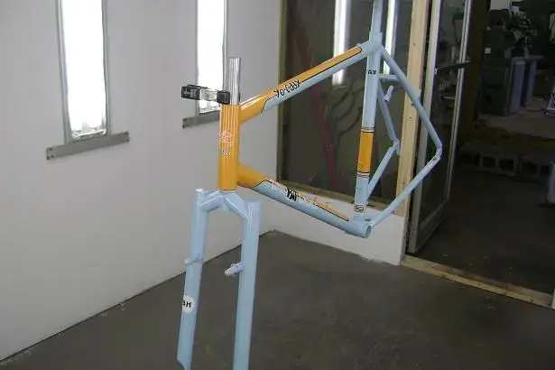

The goal for us was to remove the rack mounts, clean up the mess, and give her a new finish to match the Gulf Stream racing colors, all while bringing a smile to Bob's face.
The aftermath of the rack mounts was not pretty...the original work had left three gaping holes in the material where too much heat had been used during welding and burned through the stays. Some patient tig work and a little 56% silver closed these up good as new.
New bearings and collars, a new headset, and a good bit of patience on Bobs behalf, the YO is ready to rock!
Check her out...

I really don't like sucking ass, but that is the best implementation of Gulf colours I have seen. Nice job.
F**kin' sweet 8)
Ahem...pardon my French....very good work my man!
If ever I have a frame in need of some love, I'll know where to send it :D
Love the finish, still a dream to have a Sebring Healey replica finished in Gulf Racing colours... (might have something to do with the lush girls that serve in the Gulf shop at Le Mans :wink: )
