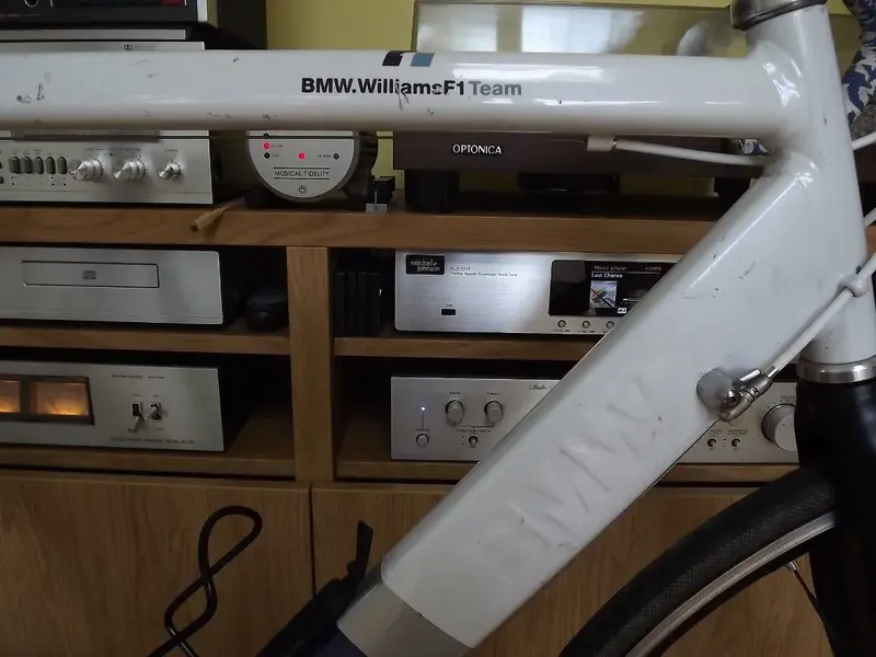

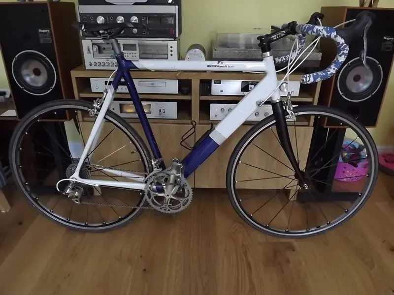

Now I had a set of slightly newer Ultegra and a set of Ksyriums spare so that was an easy build that took a couple of hours this afternoon which wasn't really worth a thread but I thought i'd put a couple of pictures of it up as it may be of interest.
Unfortunately mine has the wrong forks , the ones that came with my frame are alloy not carbon and have way too much wheel clearance at the brake bridge so for now I've had to use my trusty Gipiemme long calipers so that I can try it out and have managed to source a set of forks that look the same if not very similar to the originals which will be going on (with the Ultegra brakes) as soon as they arrive. The other slightly annoying thing about the frame and forks is that it has a 1" steerer rather then 1 1/8" but luckily I had one ion my bits box.
I'm not sure whether to get it re finished or leave it as is but for now I'm just going to use it to see how I get on with it.

As far as I can tell the frame itself was made by BMW and yes I'm surprised they didn't go for for all carbon but then I suspect it was more marketing than technology driven. The frame itself apart from the top and down tube profiles looks pretty conventional for the time.
The forks are 1" threadless which do come up from time to time and I have a set coming and hopefully the steerer is long enough but yes they do seem to come up from time to time. Being threadless I'm now on a bit of a quest and asking every seller of threadless carbon forks that look a bit old and don't say 1 1/8 to measure the steerer tube for me to see if they're 1" or not.

I had thought about that Chris but as you say its going to be difficult with the metallics getting it to lay and matching the actual colour will be a pain.
I'm going to reach out to BMW and Williams for the paint codes and the decals to see if they can help and if so then I'll get it done professionally as there is some corrosion here and there to deal with as well.
Also good to know on the forks, I've got a steerer extender to use for now and as the frame is on the upper limit for me size wise I might end up with the stem at the bottom anyway but ideally yes I would like to extend the steerer on the forks I have. I do have a friend with a Tig welder but would rather give them to someone who has actually done it before.
