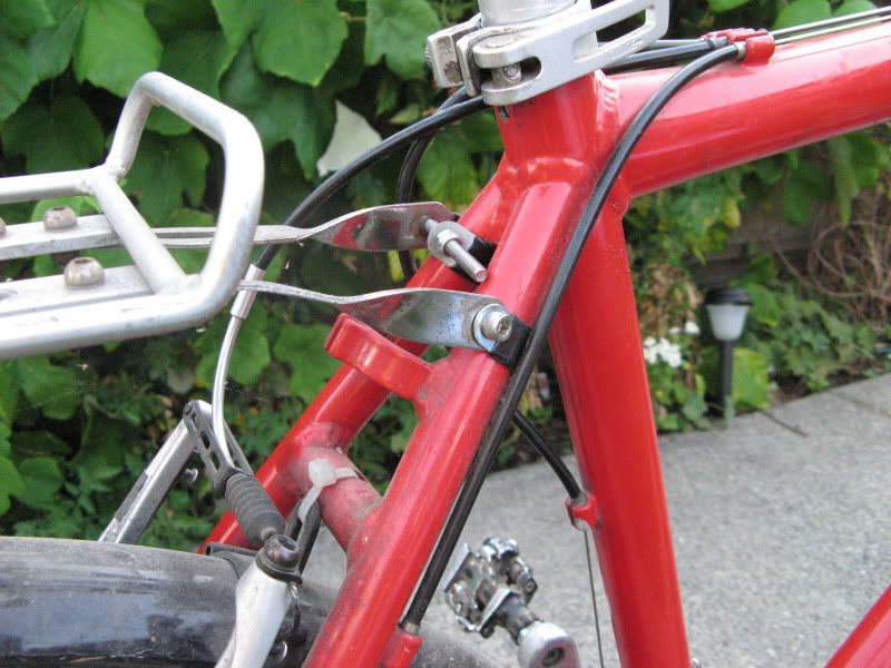

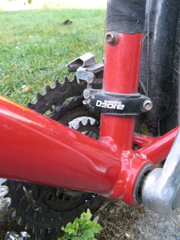

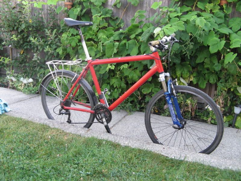

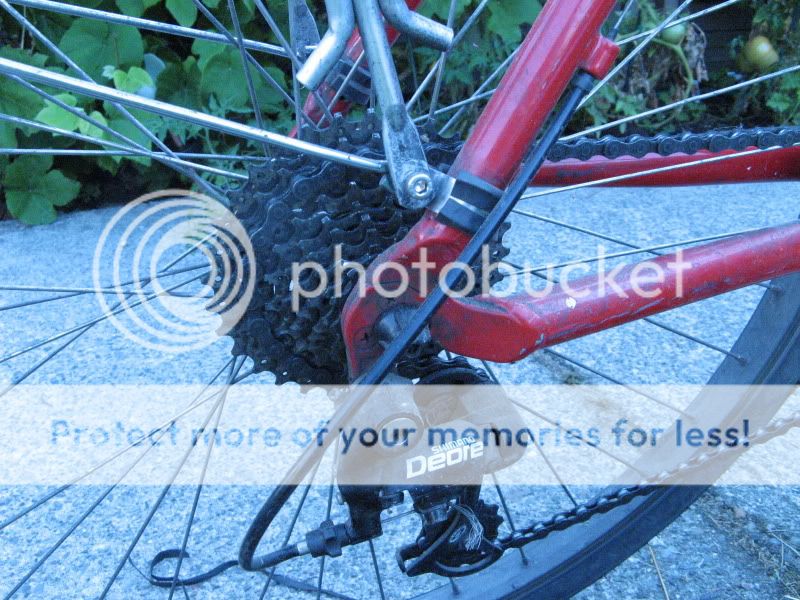

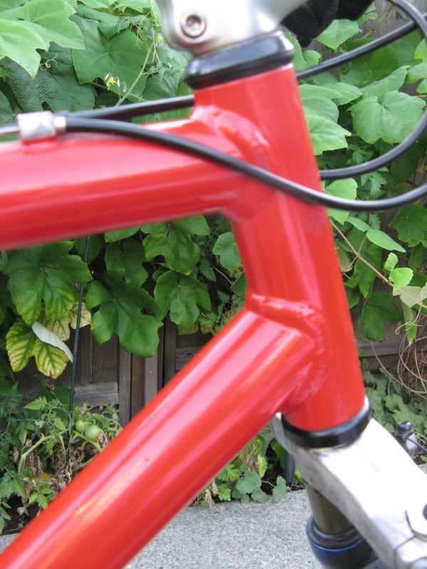

Here is a pic of Frank in his current glory.
So the plan is to replace the Z.4 with a Surley 1 x 1 suspension corrected cro mo fork with some spacers I couldn't afford because of steer tube length, replace the frankencrank with an LX hollowtech Crank and Octolink BB, put on a new Race Face XC riser bar & a new seatpost (I bought the wrong size originally). I wanted to go with a silver build, but its looking like I will have to go with black because of the components I am able to afford. I will probably upgrade the stem to something black (and possibly race face) in the future - for now its a silver Ritchey.
The bike came a nice red, but the paint job hasn't held up well. It's flaking quite badly in places. Looking at what some people have done with stripping and polishing I'm tempted to go with that if the polish can be protected from the elements so it stays relatively good looking over the long term. Otherwise I hear that I could get it powdercoated white or black for $40 if I do all the stripping and I could get a colour for $75 with me doing the stripping. I think polish would look really good with the black build and it would be cheap which suits my budget. Seat will be the SDG that's currrently on there for the time being, same with the wheels, brakes and drive train. Seeing some of the pretty canti's out there and reading what some are saying about stopping strength, I may be tempted some day to try some (the frame was designed for canti's.
