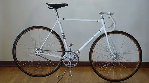

My name is Lucas and I'm from Argentina and a couple of days ago I came across this bike bianchi and I really liked. The seller says it is 1946, but I can not find anything on that model and I wonder if any of you can help me with that, the price is $ 2000 pesos Argentine equivalent to u$d 480, is a good price?

-That looks to me very much like a track bike built in the 1940's - so 1946 must be the year not the model number.

-In the lattached photo, you can see a track bike of similar age - the handlebars are very similar, for example.
-The forks are a little strange: the clearance (the space between the front wheel and the forks) is very large, which is unusual for a track bike, so maybe the forks are not original.
-Do you know much about the seller? Is it an old cyclist, a collector?
I know Argentina had a strong cycling team and was a centre for track racing in the 1940s, so try to find out some history.
-If the person is asking €480 and it's a real Bianchi track bike of that age,
it's a bargain. That's an historic bike and very interesting for collectors.

Two more observations from the photos:
-The wheel rims are aluminium or maybe steel. Rims on track bikes from this
era would normally be wooden.
-The paint is in very good condition for a bike that might be from the 1940s.
Both these suggest to me at least that this is either a restoration/respray or maybe a replica of a classic bike.

Lucas, This looks correct to me, including 5 pin inch pitch chainwheel, but I would expect alloy rims, which were in general use by the late 1930's. The rims are probably about 12 ounces, where woods were 16 / 18 ounces.
I rode my 1930's wood rims in several wet road races in 1955, without any harm. Don't believe the legends.
If you want to ride it on the roads are you OK without brakes?
Agree with Johnny about the wheel clearance, but the forks look right.
Keith

It looks like the bike has been restored and repainted. It does however look like it is from the 40's or 50's. Prices in Argentina are obviously not what they are elsewhere, but I nonetheless think that teh price is very fair to teh buyer. IN teh US that bike would likely sell for about double the price asked of you.
