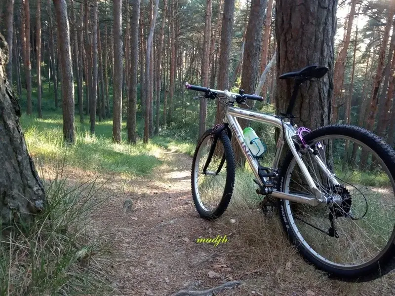

Well, it is back and it is amazing. I rode some paths and it is quite funn.
This bicycle is so envolving, you are focused in the path, you have to learn againg how to ride and be carefull.
The cantilvers have few power but enough for this speed. A 2.25" front tire helps a lot with small bumps.
I have enjoyed a lot. Firts ride and I love it. Slow and funn, different from todays trends.
Now, waiting the fork, but I like with this one. I have some problems with the rear wheel, perhaps too much funn today :lol: The second photo was too much for this bicycle and for me. :wink:

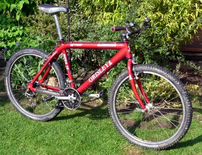

Nice, I like the red one, looks in very good condition. I have also saw in dark blue. The Mega 10 was the lowest of the range but looks nice.
