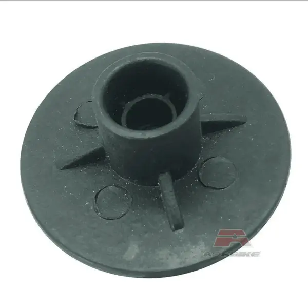

The best way is when you buy/bought a new set of wheels you save these little hub axle protectors:
(that way, the axles don't pierce the cardboard box)
Screenshot 2023-06-16 at 21-55-12 Bicycle-Hub-Axle-Protectors-Bike-Packing-Plastic-Protectors...webp
