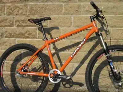

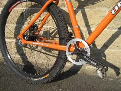

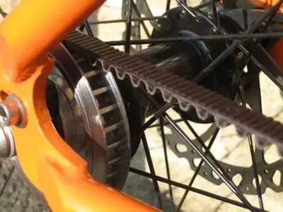

There's been some posts on forums about the tension required for the belt. Apart from being difficult to adjust due to the high tension, there seems to be a question over the load on the hub bearings as a result. Most independants seem to be spec'ing King hubs as a solution :wink:
Orange seem to be the closest mainstream manufacturer to a belt driven bike with this prototype P7.. Belt tension is an issue, and the frame has to split at the back as the belt cannot be.

Issue right now is the longevity of the rear cog...mucho debris introduced into the cog from the belt is eating away the teeth and reducing cog life.
Add in the specific frame adjustments for the one piece belt and it is a science yet to be refined before mass production.
