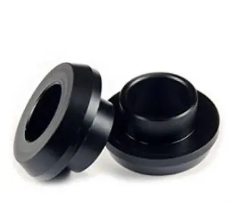

BB30 -> GXP adapter - what's going on here?
02gf74
if I understand it right the Amazon one is a reducer that fits into the BB30 inner race to allow the slimmer shaft to fit. The second is a complete press-fit and reducer unit that replaces the BB30 bearing.
I would have said that too except they look identical to me.
I contacted the seller and response was "no need to remove the bearing" which implies the ebay one fits to the bearing and has an additional bearing. (it seems most strange). :?
You shoulda gone to specsavers, they are different diameters, one is one piece, the other multiple pieces, including a bearing.
As already suggested, Amazon one fits into the BB30 bearing to alter the ID, eBay one is a complete replacement unit.
Neither of these will do anything to alleviate the problems that come with bb30 though, you really want something like the Praxis adapter that screws together/expands.
