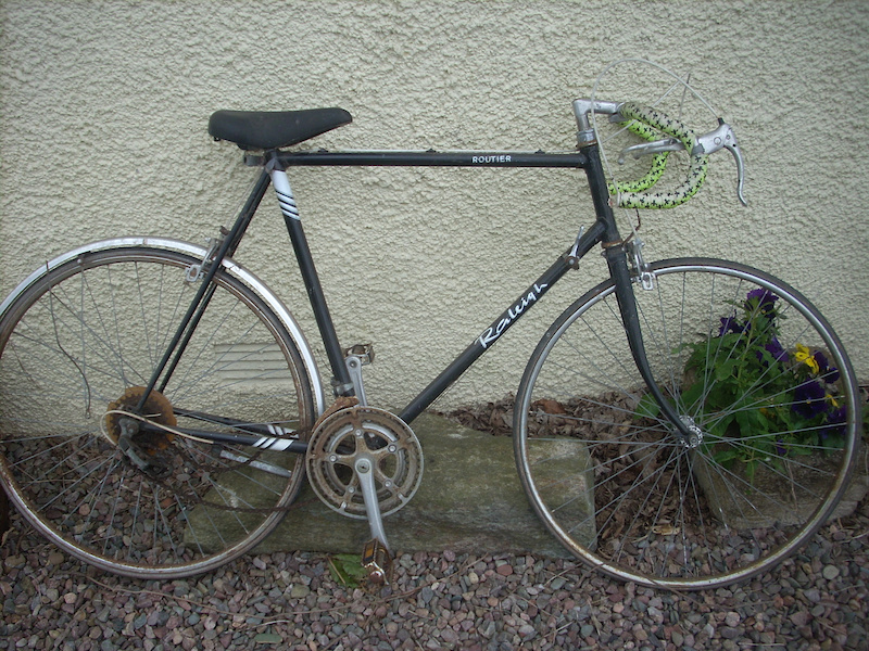

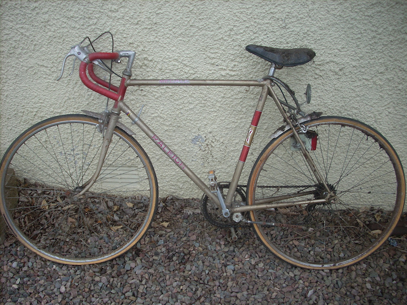

My friend has these two bikes. He's restoring them but doesn;t know what the BB size are on them :?
Anybody know the BB sizes?
Thanks.
BB size
The bottom bracket width will be 68 (British) rather than 70 (Italian). The other thing you need to know is the length of the axle, and this depends on which chainset is fitted/will be fitted. I can't tell for sure exactly which chainsets they are from the pictures. Best bet is to remove them and see --- you need the right length.
