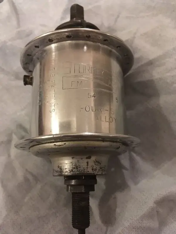

Like this maybe with shifter and probably wing nuts if needed. 40 hole.
I’ve just looked at prices on ebay. Wow shifters almost as much as hubs.
Don't discount the FW. The ratios are reasonably close together and it's much more reliable than the FM. Don't get a 4-speed hub that's been rebuilt by anyone unless it's guaranteed - these only work if the spring set inside the hub is matched, and mixing springs from early and late hubs means you can't get 2nd gear.
