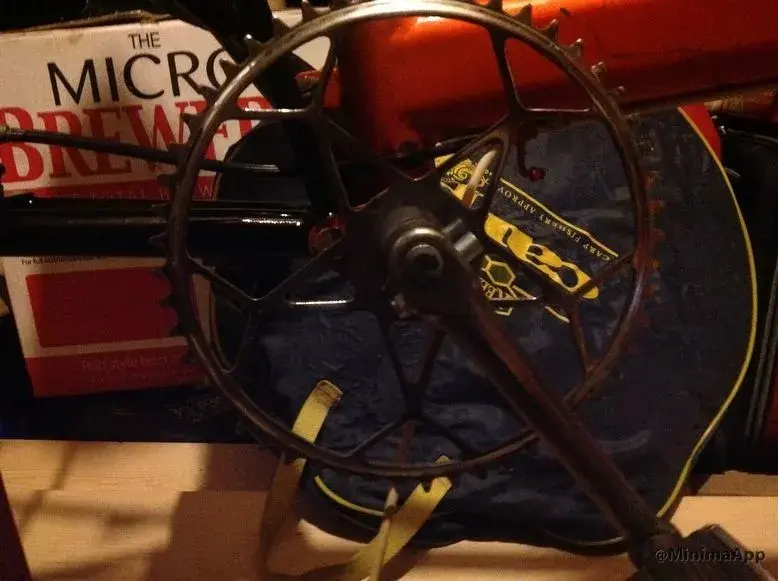

Do you mean a chainset axle length such as this? If yes, will try to measure later.
Yes, something like that. From a bit of research I've done it could be 125mm, but I'd like to know what yours measures if it's not too much trouble.
Not sure of the axle length but your front chainline measurement, centre of BB shell to centre line of chain ring should be approx 42mm (according to Sutherlands Guide for Mechanics) - that is for a 68mm shell with a 120 OLN rear end. Having that 42mm dimension may help determine the overall length of axle, so 125mm sounds reasonable.
There are several lengths. The two basic ones are for bikes with or without chainguards. I'll measure mine.
Well, I think statistically mine is what you would call an outlier!
I have had to measure it in situ. I couldn't face the whole cotter pin misery again! I managed to get the micrometer on it though and it came out at 144.5mm.
That is total length end to end.
