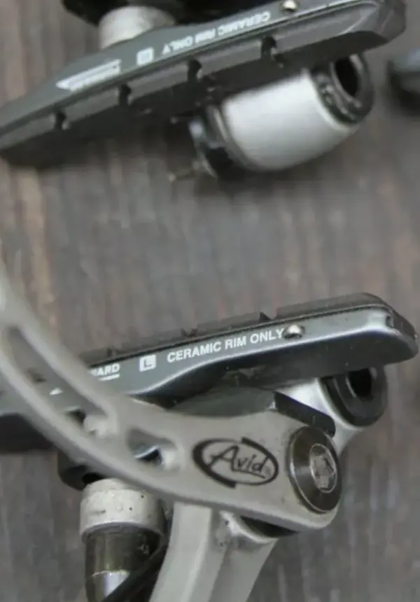

Does anyone know if you can / how you disassemble Avid Arch Rivals where they bolt to the frame? It looks like this may be able to be unscrewed for servicing - the black part at the back of it seems to be screwed into the black bit at the front to contain the spring and pivots etc - but for the life of me I can’t work out how...
I've just done this with mine. You need s small screwdriver and at the back where you can see the spring etc there should be a small cutout. Gently prise apart and that should do it. It all pushes back together after. Mine are on the bike so a photo is a bit tricky.
Brilliant - thank you! I figured it must be possible but was a tad reluctant to dive in and start yanking at things :)
