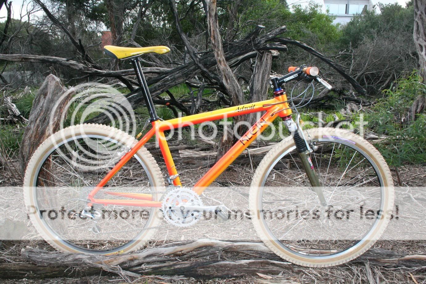

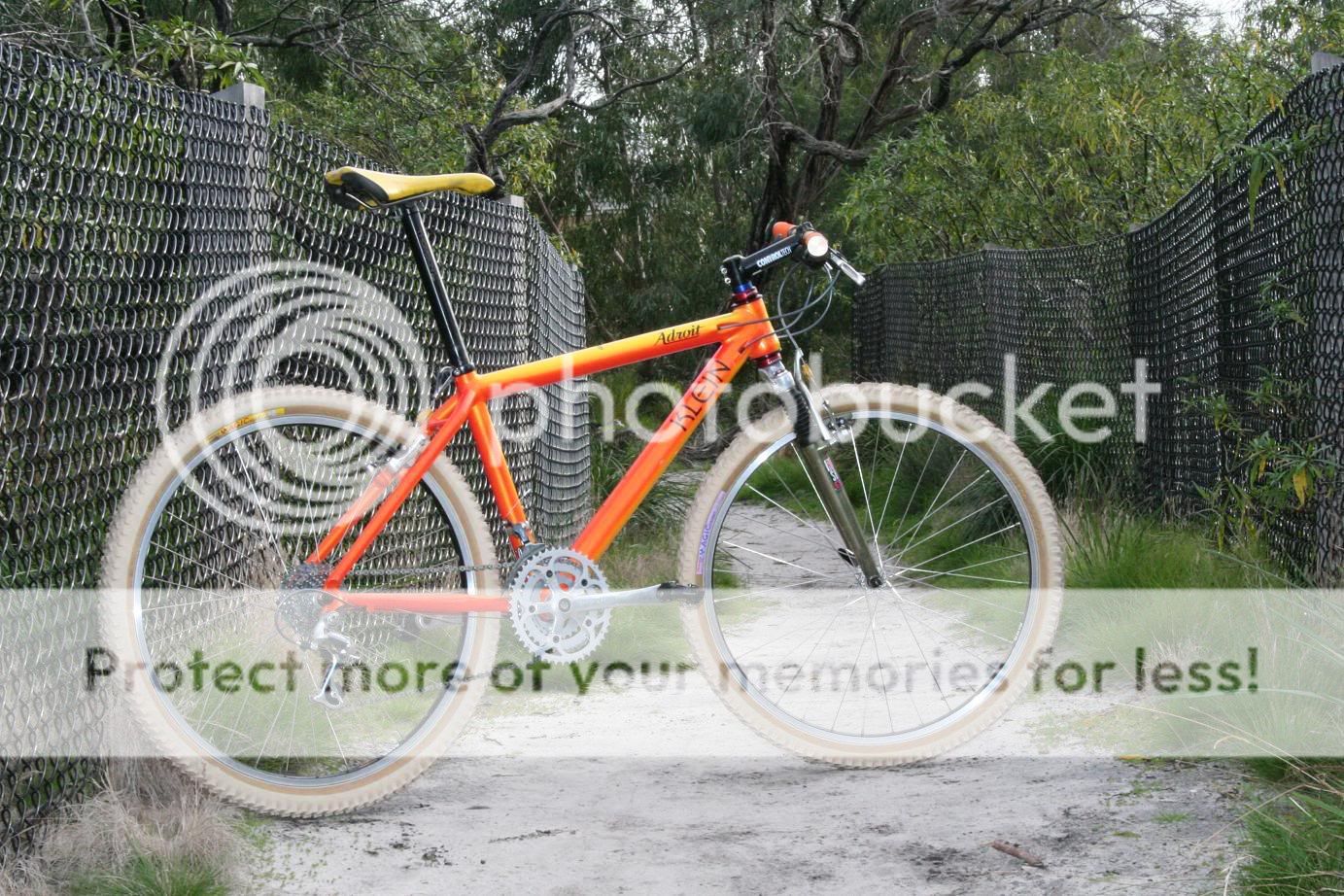

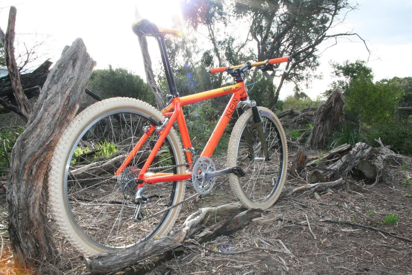

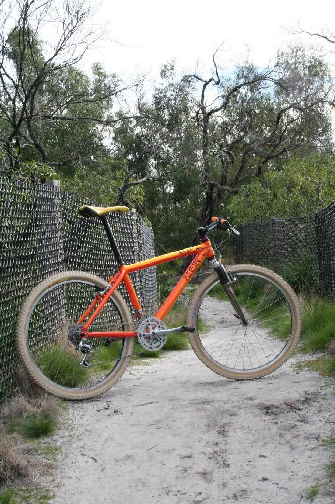

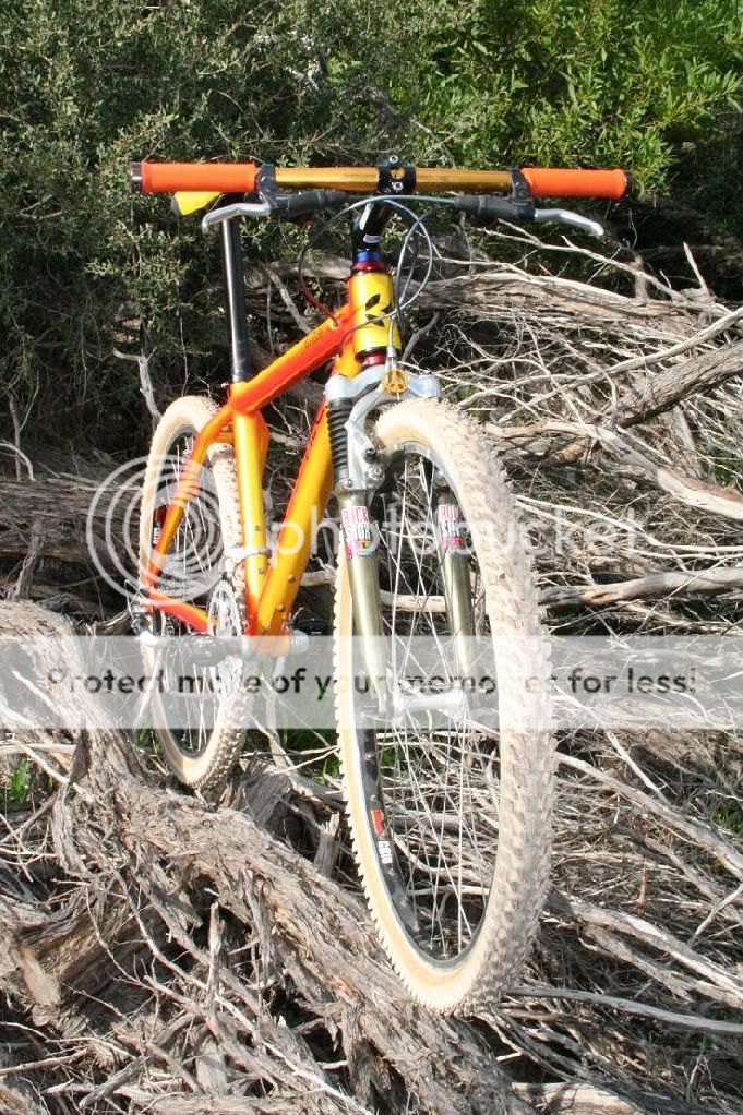

Here's my '97 Adroit, just finished. It's by far the 'flashiest' build i've undertaken. I tend to go for the 'understated' look but when you start with a frame colour like this one you can't help but get out of control! I know the Klein 'purists' on here will scoff at my build based on a 'post aquisition' frame but i'm in love with it! Took it for a quick burn this afternoon and it feels bloody briliant!
Spec's:
Frame: '97 Klein Adroit, 18" KOI paint scheme
Fork: Rock Shox SL Ti, 1 1/8" threadless (thinking about swapping the fork out with my Judy SL w/White Bros Hard Body cartridges...)
Headset: Cane Creek Lanusse, Red anodized (with Problem Solver reducers)
Stem: Control Tech 1 1/8" 135mm
Handlebar: Specialized S-Works, Gold anodized
Grips: Zero lock-on - Orange
Barends: N/A
Brakes: M900 Cantis front & rear
Brake Pads: Kool Stop, Grey
Brake Cables: XTR
Cantilever cable hangers: Vanguard Peace Symbol,Gold anodized
Brake Levers: M900 XTR STI
Shifters: M900 XTR STI
Front Derailleur: M900 XTR 34.9 DP
Rear Derailleur: M900 XTR
Derailleur Cables: Dura-Ace
Cassette: M900 XTR 12 - 28
Chain: Shimano HG91
Cranks: M900 XTR, 175mm
Crank Bolts: Shimano
Chainrings: Sugino
Chainring bolts: Black alloy
Bottom Bracket: UN91 73/113 (should realy have a 107)
Pedals: Shimano M737
Hub Skewers: Roval titanium
Rims: Sun CR18. 32 hole
Hubs: M900 XTR 32 hole
Nipples: Brass
Spokes: DT Competition 2.0, 1.8, 2.0
Tyres: Panaracer Magic Front & Rear
Tubes: Rubber
Saddle: Selle Italia Flite Ti. yellow w/kevlar corners
Seatpost: Thomson Elite 31.6
Seatpost Binder: Klein
Weight: 24.45 lb (as pictured)
