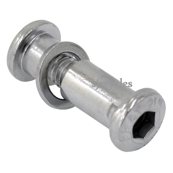

Allen key nut thing

Glueing on a nut? Doubt that'll be stong enough.
