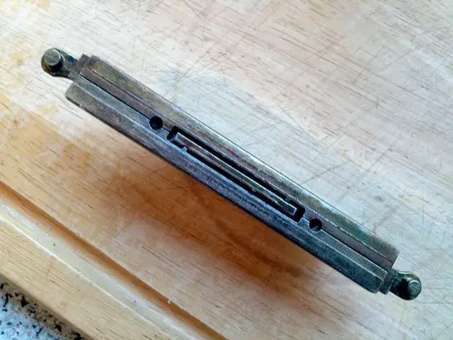

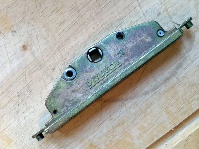

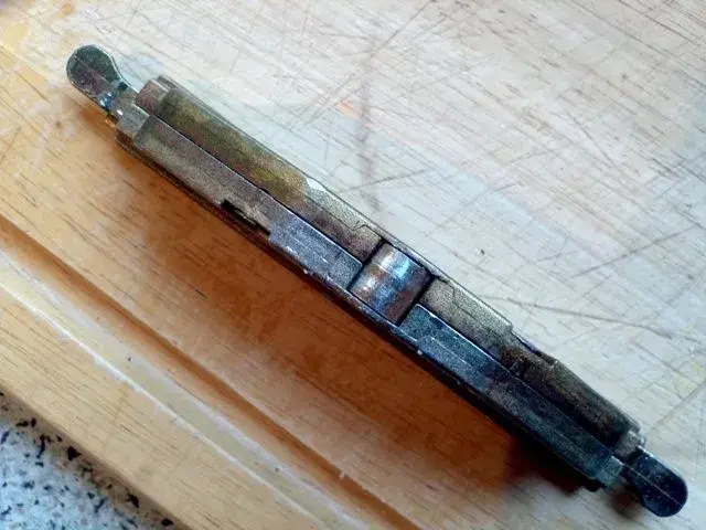

I need a bit of help please.
One of the locks on a window has decided to give up life and not work :roll:
Its a Vector jobbie
The lock will not fully close and is a sealed unit.
Does anyone have any idea where I can get a replacement from?

The handle just turns a square shaft in the square hole and pushes the lugs at the ends of the unit and the latch out which pushes two rods that engage into the window frame.
Spray it full of GT85 or similar. It'll clear out the stuff that's in it. Usually fibreglass grains and other such stuff.
Well, Opened it up and the cam slider was in peices :roll:
