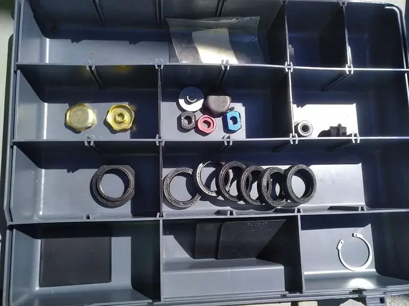

Well, I think I have some original Marzocchi oil seals 30mm left. Need to inspect my boxes.

Here we are ... 1 dust seal and 6 oil seals are left (and some knobs I don't know where for in detail).
