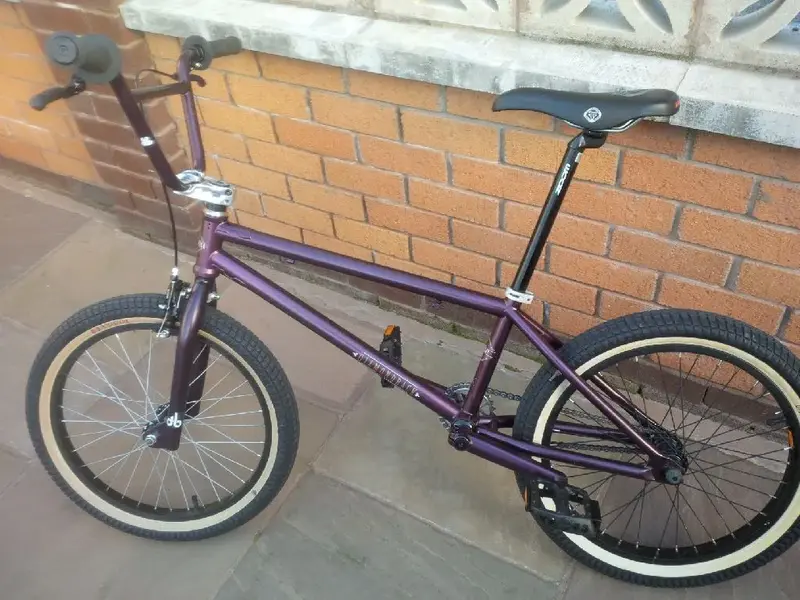

How much is too much exposed seatpost on a BMX?
I'm running a long one (400mm) on mine, and most of the seat-tube must still be full of seat-post, when lining up a tape measure, but there still looks a lot out, wondered if that had been known to cause issues - I see as much, if not more, on MTBs, but then they tend to have bigger frames. It's a full 4130 frame, heat-treated, so should be reasonably strong. Worrying about nothing, or should I keep the seatpost a bit lower (will make more sense with pics)?
Thing is, because it's 400mm seatpost, even inserted as far as it'll go, there's still quite a lot exposed.
Pics...
It would be running a rear brake, except despite all my tinkering, the one I bought - in a very fetching purple, won't fit as things stand. The stock one works fine on my sons (below) though. So if some shorter bolts, and some spacer / washers to move the u-brake arm slightly forward on the boss don't work OK, I'll just try and get one like the stock one on my son's.
As you can see from the picture, the brake blocks are at the lowest part of the arm, but otherwise, there's plenty of clearance around the tyre.

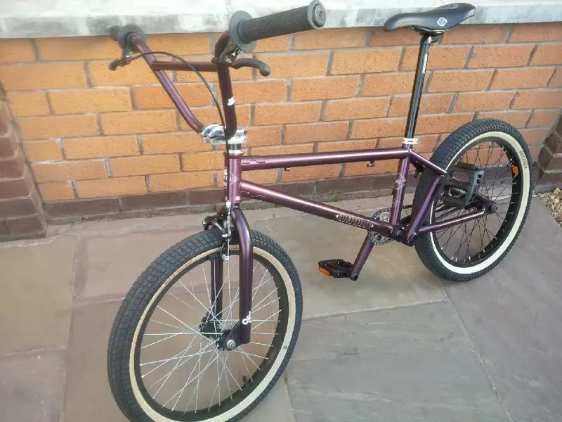

And my son's:-
Front wheels on both are cheapo replacements, as the stock front wheel(s) doesn't have a braking surface. Slight snafu on mine, I was so sure that when I got one for my son's bike, it was the thicker axle (think it is on the back wheel), so that's what I ordered for mine... Then it arrived, and I realised you should always check first, because the front dropout only take the thinner axles. Doh!
My plan was for mine to be the testbed for running a dual-pivot caliper at the front, and once I was happy (as I bought two) I'd put it on my son's bike, but I can remember setting his up and finding it worked better than I expected, and then being a little underwhelmed with the one I've just put on mine. So think I'll leave that in obeyance for a while, and see how things pan out.
