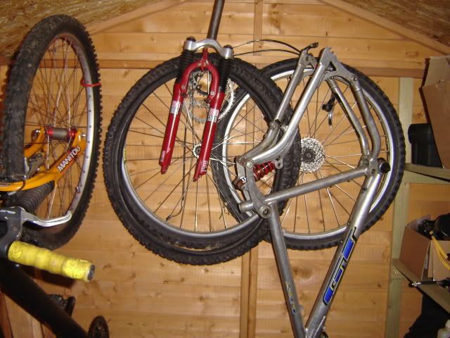

Well, BarneyBallbags seems to be doing the exact same thing as me, so I thought I'd start a thread too!
Picked up a 96 16" LTS for not-much-money, the aim being to build my 'Teen-dream' bike from the mid 90s.
I loved the british kit at the time, but couldn't resist the gimick-loaded yank frames and forks. The build will reflect what I did/would have bought.
I have some bits lurking in the shed already:
Flite Transalp
Suntour thumbies
Red Hope Ti-glide & Fatso, DB spokes, Red alloy nipples and Mavic 231s
XT rear mech
Club roost bars
Recently picked up:
95 Judy DH
NOS Panaracer Dart
Got some other bits lying around too...
Most of the stuff needs a REEEAAAL good clean/polish/paint, so this isn't gonna be an overnight build, but here's how she sits tonight:
Oh, and I only have enough room for 1 bike, so this it, and is gonna be properly used too.
Comments welcome! :D
Especially interested in suggestions on missing components!!

Looking at the decals on yours, I think mine might be a '95. What do you think?
95/96 is confusing me, yours has '96' style dropout/mech hanger and canti bosses, as does mine, but mine has no canti hanger on the rear; v-brakes only...
a 95 should have 2 bolt mech hanger, and canti bosses angled so that v brakes can't fit?
Weird.

From the decas it looks like yours is a '97 and Barney's is a '96. Perhaps the canti hangers were removed for '97?
Okay, but from 97 they had the Alu shock linkage and 'trunnion' style shock?
Perhaps mine is a late 2006/early2007?

Yeah, the canti bosses are at the right angle. On the 95s the bosses were at a right angle to the stays. You can see on yours they are angled towards the dropout, giving enough clearance.
