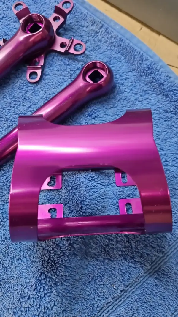

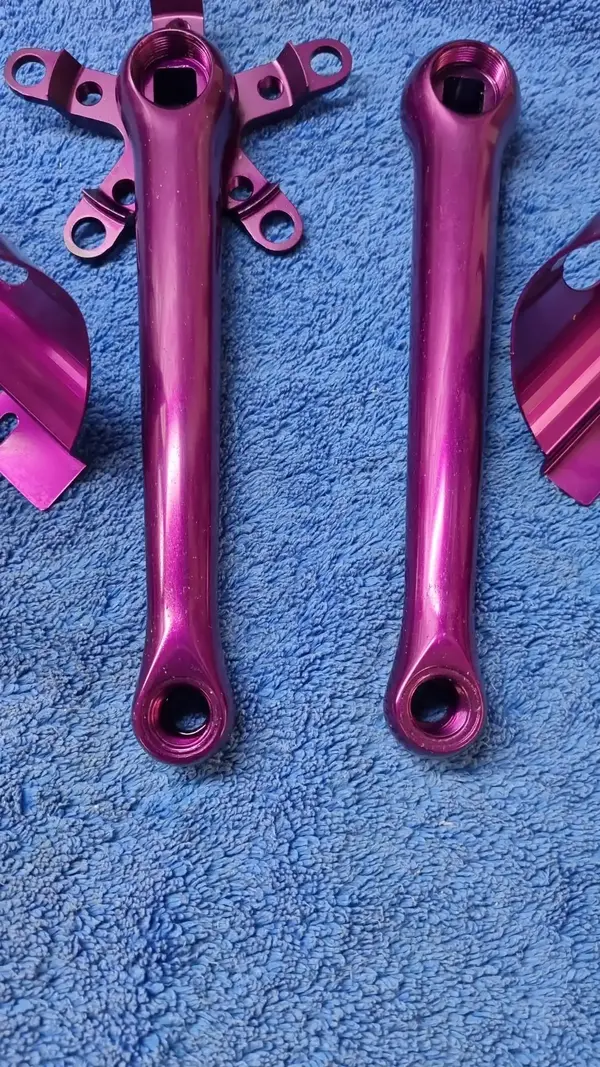

I have seen a few posts asking about where to get anodising done. I have just had a thoroughly great experience with Pete Walsh at Badger Anodising in Birmingham, who did a fantastic job for me, quickly and with excellent straightforward communication. Ringle cages and tune crank PHOTO-2023-03-02-13-36-07.webp PHOTO-2023-03-02-13-36-04.webp
Good to hear of another anodising source with positive results. 😎 They look great! 👌 As long as you like purple/3DV components that is... as we all know the colour can be quite polarising! 😜

No point to this post really, just yammering. Nice cranks though. Those are sexy.
