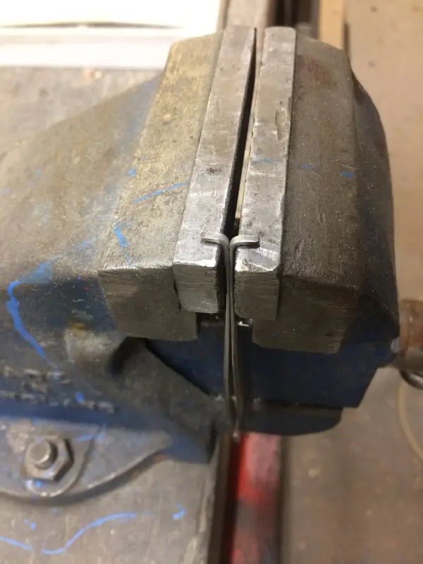

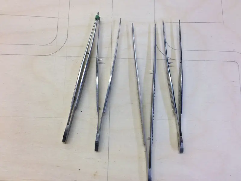

You could also try needle point surgical tweezers
Peen the ends over
Grind/file so the fit through the hole
Twist the tweezers so the pass through the boss.. maybe add a blob of epoxy
When the epoxy has set.. try and wiggle them out.. personally I think you’ll have more success with the loop method but this is also worth a try.
