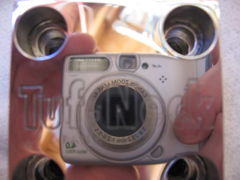

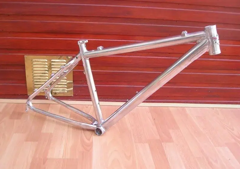

The results were fantastic shown below, left for the same period of time as Mr Muscle 30 – 45 min I then proceeded to get the kitchen scouring pad on and within no time at all I was down to the alloy. I have still got a way to go yet and I will post my final results up but this stuff realy works great and I would estimate it would only take 3 – 4 Tins to complete at a cost of £4.60 and a bit of time of course.
Be aware that on bare alloy the oven cleaner will leave a black deposit but this will clean off after.
Hope this helps someone out,
