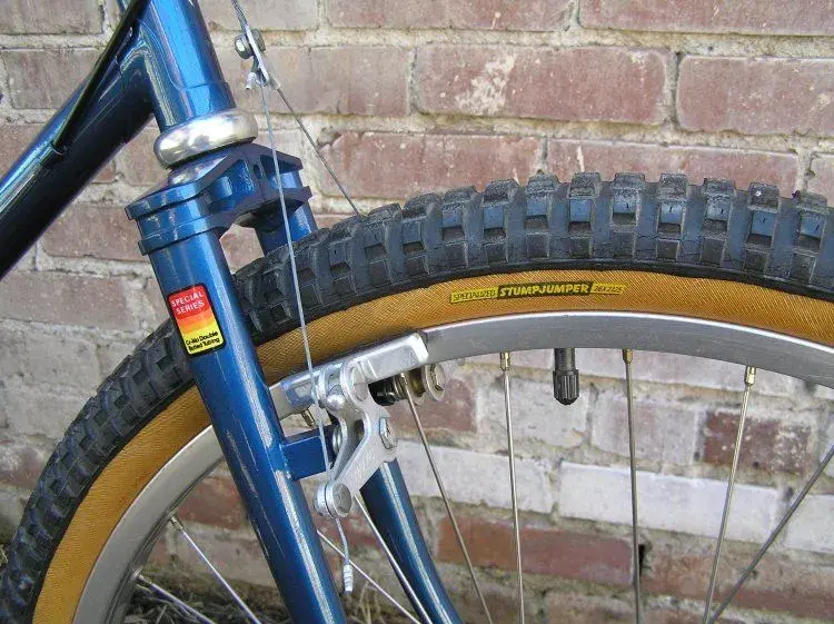

One thing I can't quite believe is that the bike in this photo has Specialized StumpJumper tyres ??!! But again, maybe I'm just not aware of how much MTBs had evolved by 1982.
You can see the Mafac brakes. I wonder if that's one of your wheels ?!

1988_Ben":3r1t2haz said:
Thanks for this great info Mr Repack !
I just had a look through some old books, and found my 1982 International Cycling Guide, which featured a similar bike in the listing of California frame builders (see below for scan).
There is a nice picture of an 82 Stumpjumper tyre + bike for that matter on MOMBAT
http://mombat.org/1982_Stumpjumper_1055.htm
The Stumpjumper tyre was the first product from Specialized for the off-road market. It appeared in 1981 and the first advert for it ran in the Fat Tire Flyer. Specialized did not even supply artwork, so our house artist drew a tyre. My regular computer, which has that image on it, is in the shop right now but when it gets back I will post the 1981 ad for the Stumpjumper tyre.
