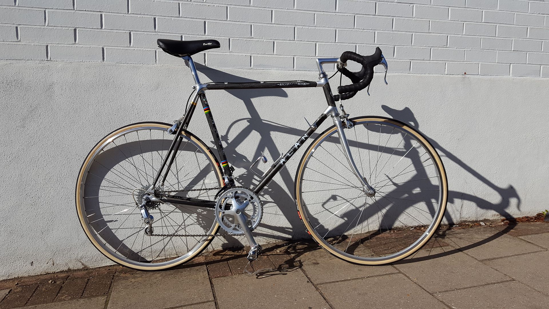

The idea is a 1987 C-Record build, in as close to NOS condition as I can manage (but I do plan to ride this bike, so it won't be a wall queen). I've gone with a black trim theme rather than the strictly correct white hoods, cables, tape etc - so sue me.
Just built the front wheel this morning and chucked the bar tape on. First ride (just around the block, really) seemed to be OK, so here it is so far...

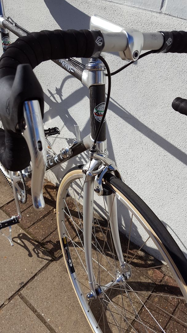

    NOS C-Record Delta levers with new hoods
    NOS C-Record Syncro II shifters

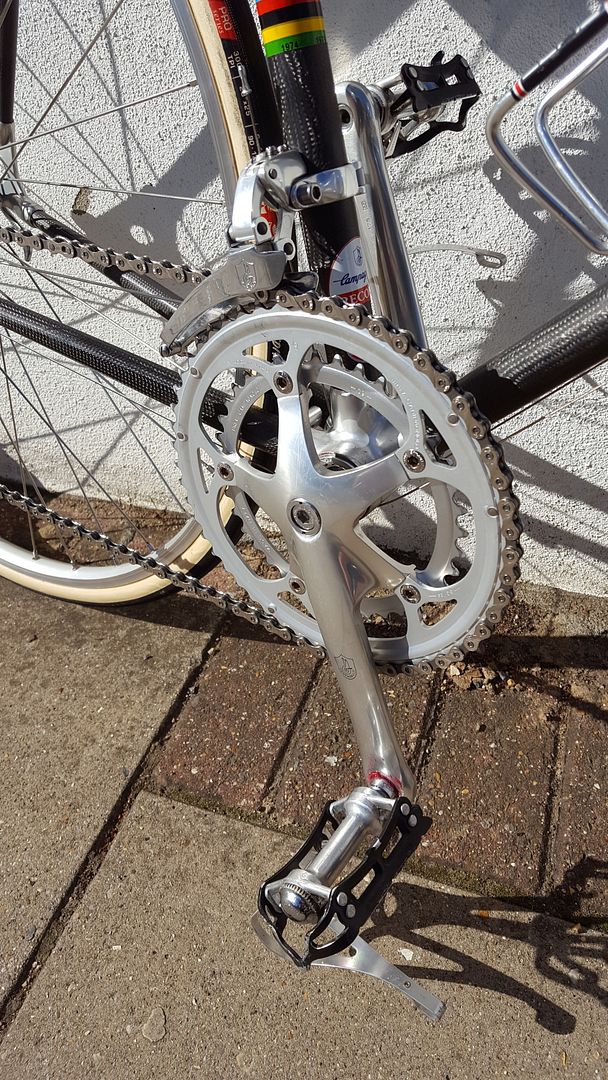

    Used Chorus (90s) chainset (looks like late-80s Croce d'Aune) 175mm
    Used Campagnolo chainring bolts
    NOS Record 53/39 chainrings
    Used Super Record pedals and Campag toe clips

    Used 3TTT stem (110)
    Repro Cinelli Giro d'Italia bars (42)
    New Cinelli cork bar tape
    Used Super Record headset
    New Jagwire cable outers
    NOS Campagnolo cables

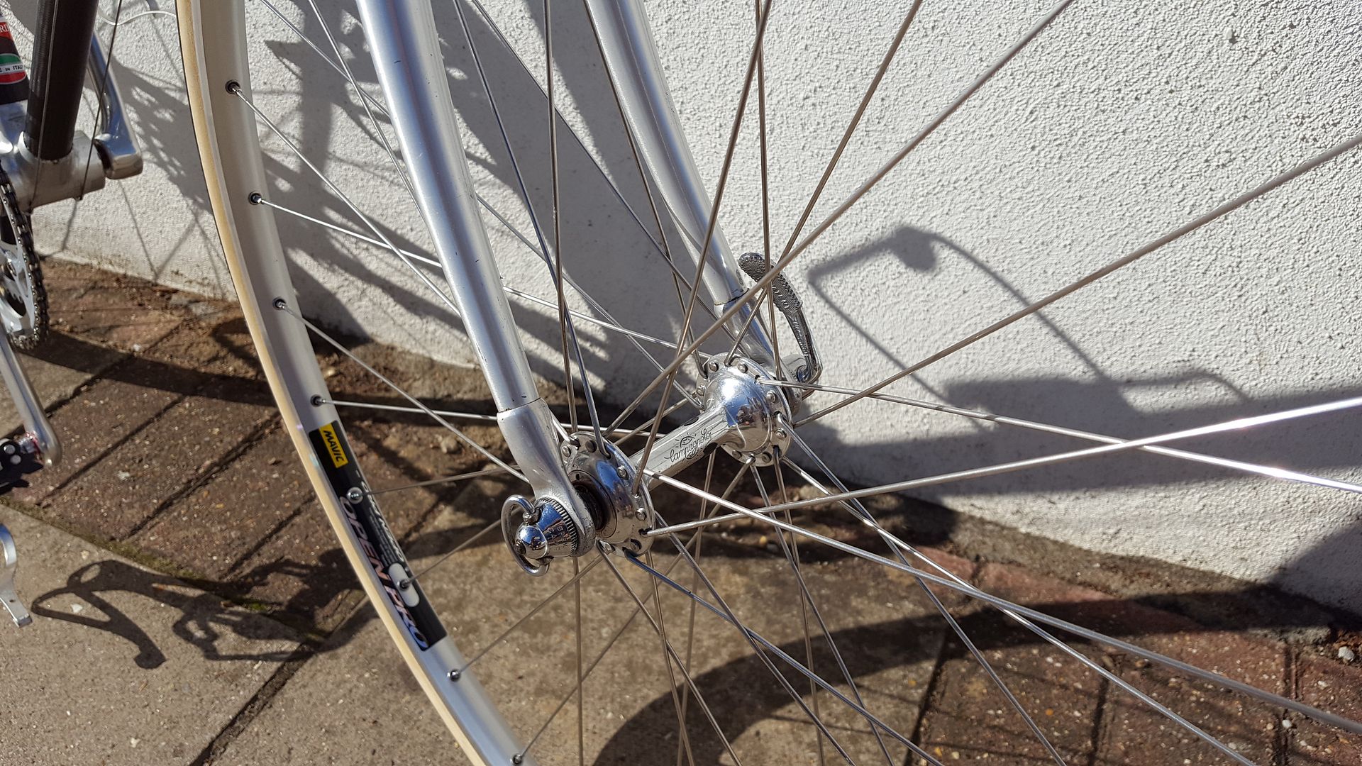

Classy looking bike, a bit after my time but very smart :). Is the valve between two spokes that are converging on the front wheel ?
Shaun
Hmmm. Yes. I may have to rebuild it. Goes to show what happens when you're in a hurry to finish something.
Re: First retro build in progress: Alan Record Carbonio
Tbh I don't think many people would notice, it's just that I worked is bike shop way, way back in the past..... doesn't detract from the look of the bike :)
Shaun
Blimey that was quick :).
Is the clip covering the oil hole now? I'll get my coat :D

Proper Chainrings would look allot better
I have to say, although a steel fan, that looks pretty damn classy. Great work.
