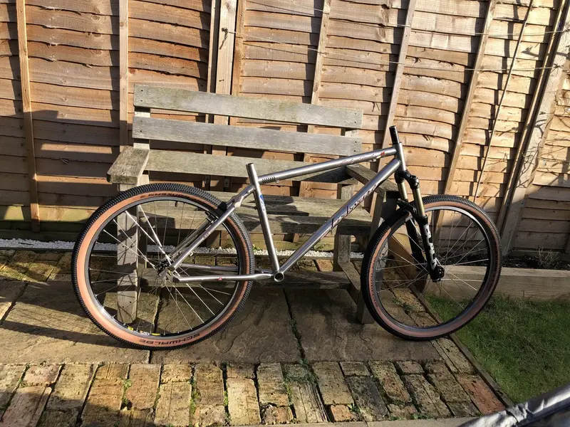

I had previously built this bike up with full XTR M952 kit 3x9 etc and while I liked it, I found that it didn’t really fit the bill for me.
I did actually offer the frame for sale a while back once I’d broke it down and sold most of the components but no interest, so I stashed it away for a while.
Sometimes it’s good to come back to things afresh. I decided to rebuild this with some parts I had and a few others I needed to buy. Wanted to make this my go-to hardtail as it really rides nicely and is a perfect fit for me.
I got a fair bit done on it today, needs rear brakes (v’s), controls and cables to finish.
Looking good so far, will upload photos once complete and do a spec list too..

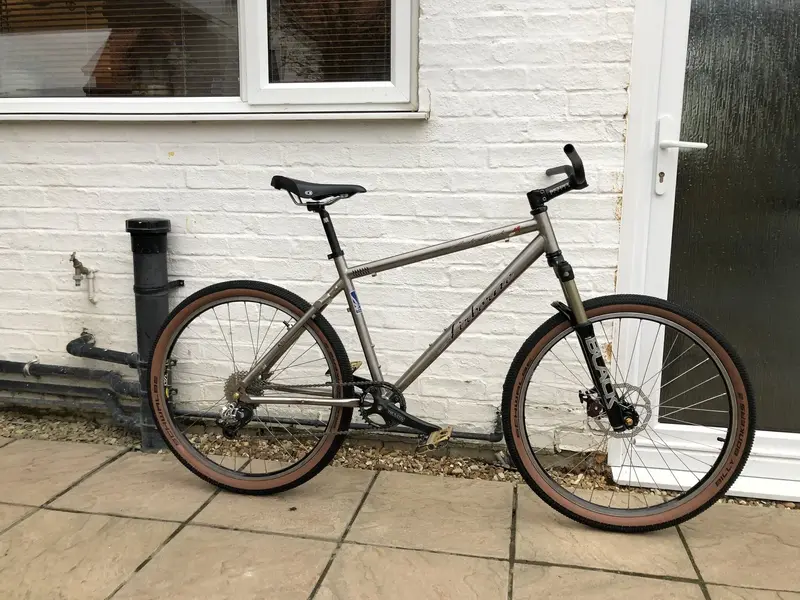

Got this finished off and pretty happy with it all in all.
Spec:
Mavic xc717 rims and Hope evo II hubs.
Manitou Black 100mm forks.
Billy Bonkers tyres 26x2.1
Gold Hope skewers
Avid Bb7 disc front and V brake rear with Avid levers
Cane creek C2 headset
Race Face stem
Titec Ringleader bars
Cane creek grips
SRAM X9 shifter
Un72 bb
Truvativ fiveD cranks with eBay 32t n/w chainring
Crank bros 50/50 pedals
27.2 seat post
Crank bros Iodine II saddle
9 speed cassette
SRAM XO mech
Think that’s everything, will update with a few more pics when I get out for a decent ride on it.
Great looking build with some very nice bits! I maintain that billy bonkers are one of the best looking 'modern' tyres you can get. There's not much that they dont look good on.
