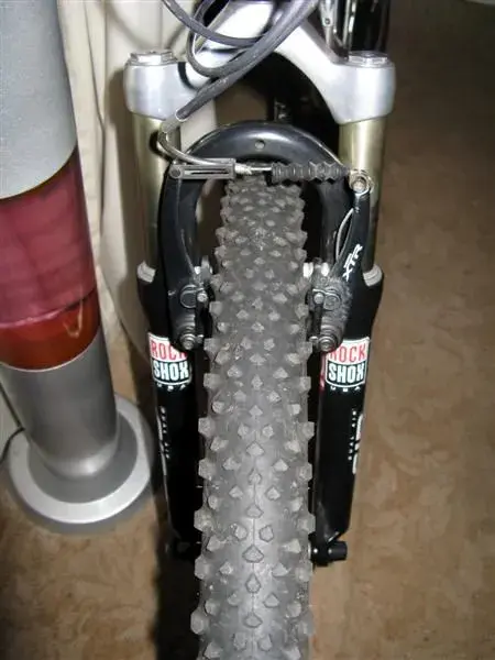

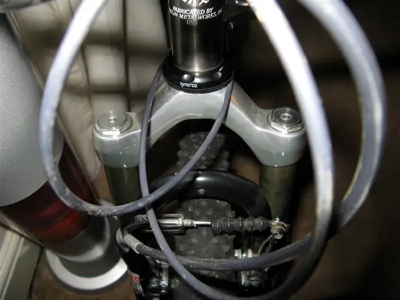

Forks are RS Sid Dual Air, no obvious signs of adjustment knobs and seems from my limited knowledge to take the needle type adaptor thingy.
Not even sure what model or year they are, just says Sid, Dual Air,Black with 1in bonded steerer
Would these just be adjustable from the amount of air you put in and if so what sort of pressure? (told you I was naive :) )

Thanks for those and loads of good stuff.
What is the negative air spring? all I can see are the two top cap screws that come out to access where the needle valve goes.

Unfortunately the pos and neg air pressure is different and no idea which is which.
From what I can gather going for the right as pos, but not entirely sure :?
Need a better pic to maybe tell you which year those are, but on mine -ve air is at the bottom not the top. WuTangled is an expert in SIDs.

Thanks Anthony, nothing apart from the leg bolts on the bottom of mine, just the two top screws. Ok for now, but when they need pumping up would like to know what i'm doing.

I think your forks only have +ve air adjustment. The -ve used to be at the base of the left leg, which isn't visable on your photos. The -ve air forks also used shraeder valves, not the needle ones.
From memory i ran 55-60psi in the both legs (they are both +ve) that was when i was around 10 stone :roll:
Things is though you just need to ride them and see what works :D
