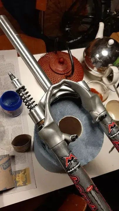

Your question motivated me to build a Z2 that I had dismantled some time ago.
To get the oilseals out I'm using a very long motorcycle tire lever with a piece of cloth to prevent damaging the paint. That works perfectly.
To push new oilseals back in you can use a 30 mm socket. This again fits perfectly and makes the work very easy.
Before you put the dustseals on the gold coloured stanchions you can put some oil on them first. It also helps to put the stanchions into the fork legs..
This weekend I'll finish the build. If I find out anything about tuning I'll let you know.
