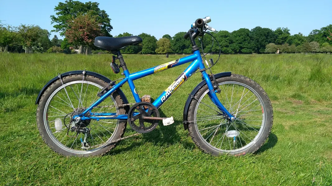

He's currently on a 20" bike built from two bikes that were abandoned near me with completely rusted up chains, dead suspension and broken spokes. I saw the frame of the one with broken wheels was perfect and the wheels of the other one with a rusted up suspension frames were solid so I took all the good bits off both, treated them with evaporust, regreased everything and just bought a new chain and mudguards and this is the result. Not the lightest but son is happy with it.
