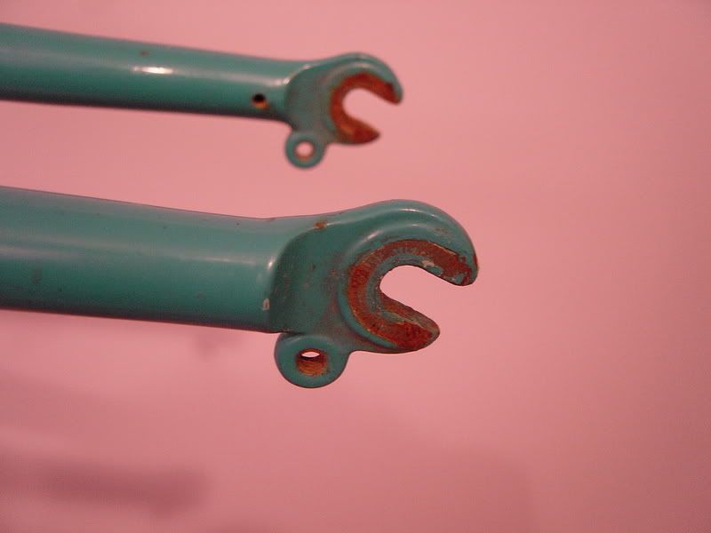

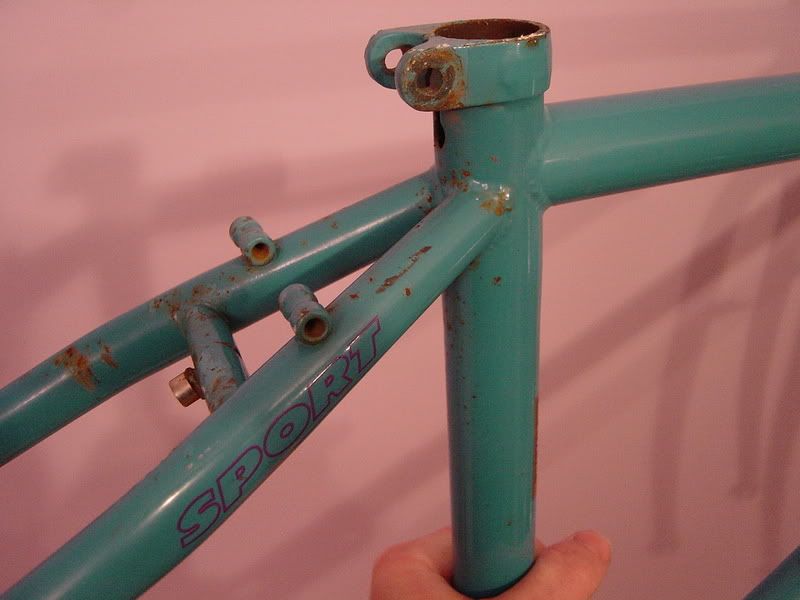

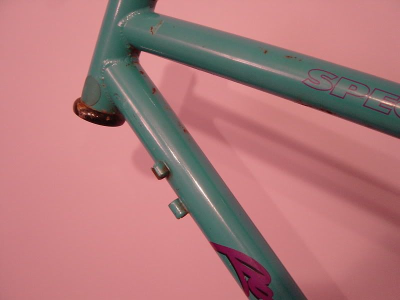

OK, I finally pulled my finger out and got the frame up to my house, hopefully someone can help out with the year of manufacture. The frame color on this pic with the flash on is quite close to how it looks normally, the purple graphics have a glitter in them (The crank is not original) :

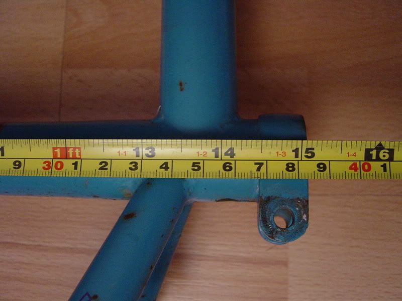

Not sure how specialized interpreted their frame sizes but this is from the center of the BB shell

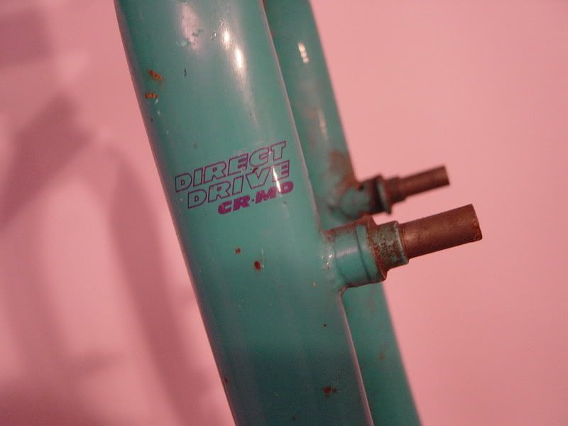

Extra cable stop on down tube for U brake :

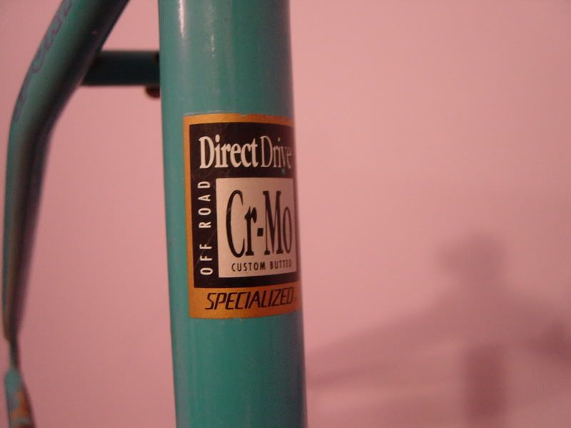

Other general pics that may help people identify it :

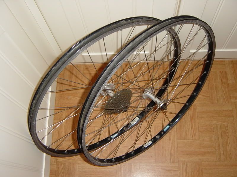

The only bits we are sure that dad didn’t swap are the wheels :
32 hole black Specialized BX23’s, stainless spokes with Shimano hubs. Other than the bearing covers only the rear hub has ID on it – FH-HG50 Exage Sealed Mechanism, It is 7 speed.

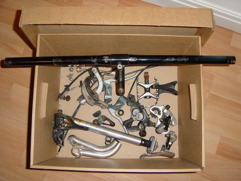

The stem (not much can be seen from this) :
It’s a black Specialized Cro-mo, the front brake cable runs through the extension. I didn’t measure it but I think it’s about 110, 120mm ish
And the headset is also original, it’s a black steel Tange 1” threaded.
We are not sure on the following but guess they are also original (they can be seen in the box of components) – Pedals, seat post & brake levers.

The decals are very much 1990 as in 91 they were different, as they didnt have the little American flag next to the specialized.
Not to sure with the brake either as I have had small Rocky's and Stumpy's and they have standard brakes as their bigger siblings. I currently have a 13.5 Rockhopper and its got canti's and noodle just like its bigger siblings.
