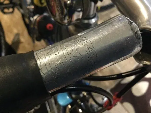

Im putting this down to a hair line crack but If anyone else is running vintage bars I’d give them a check over or better still change them for something newer.

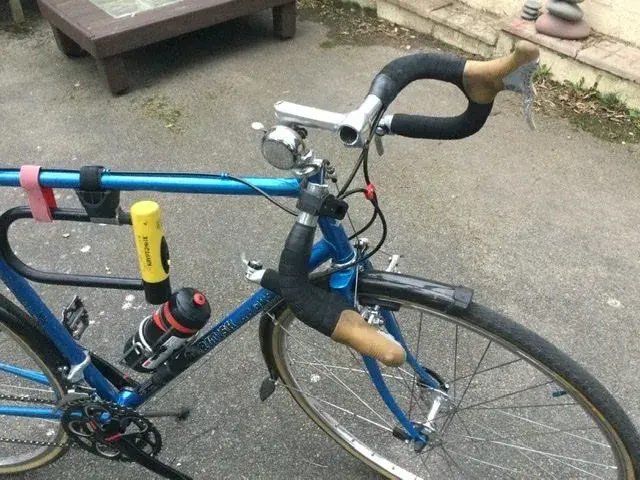

These we’re GB Randonneur‘s & I’m guessing around 1950’s or 60’s so yeah pretty bloody old but I never guessed this would happen , luckily id just left the road and entered a cycle lane running alongside , slightly going uphill with the wind behind me as I got out the saddle with my weight forward , BANG ! was down in heap !

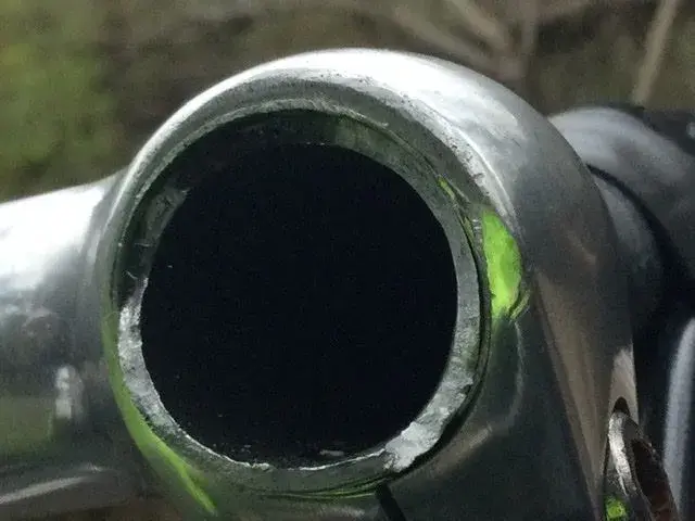

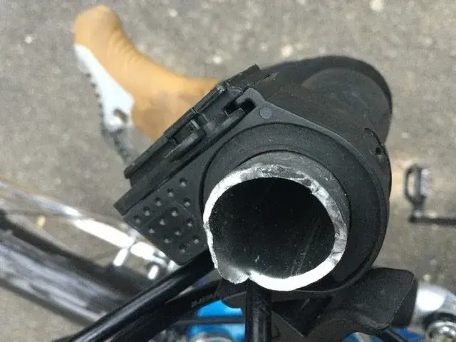

Im thinking the dis-coloured part at the top of the break was a crack that was just about hidden inside the stem , the rest you can see is a clean fresh break .
25.5mm bars with a shim to 26.0 cinelli stem . I’ve used these bars for various builds over the years and I’m just glad they gave up where they did as things could of been a whole lot worse .

What a shame! Glad you weren't hurt, anyway. I remember 3TTT used to advertise the fact (I think) that they were the only manufacturer to be able to give a three-year guarantee against breakage. I'm still using a pair of 3TTT bars I bought in 1991, and which have now done 50,000km.... 🤔
