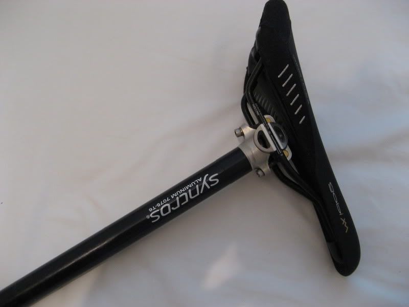

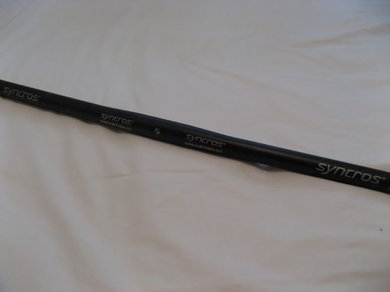

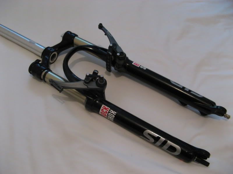

I've got a Syncros bar, stem and seatpost for it and probably going to go for a SID Team up front

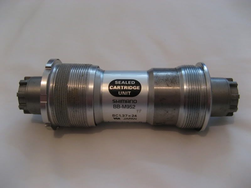

Drivetrain wise I was going to go for full M952 XTR - already got STIs, brakes and BB - but was thinking it might be a bit samey and maybe go for something else for cranks, maybe Race Face. Any suggestions?
I would want to know how the length of the SID compared to the length of fork the frame was designed for before I decided on the length of stem to use. It's a great frame, but Obsyss were short. I would guess you need a 10cm stem at most for an SID.
I was a bit worried about the length of that SID too - its around 455mm axle-to-crown if I remember correctly, don't know that how that compares to the Obsyss but a fair bit longer I suspect. I've just bought Wadsy's SID World Cup which I might use instead, and thats 440mm so should be better.
yeah your sid has 6cm longer atc compared with an obsys carbon, which is the most proper fork for this cool frame ;) got a couple of sunns myself, and don't ride anything but obsys carbons.. mmmm 32mm sweet travel ;) hihi

yeah your sid has 6cm longer atc compared with an obsys carbon, which is the most proper fork for this cool frame :wink: got a couple of sunns myself, and don't ride anything but obsys carbons.. mmmm 32mm sweet travel :wink: hihi
I would be tempted by a Obsyss carbon, but they seem to be rarer than rocking horse poo, and I have bad memories of the standard Obsyss on my Vertik - I swear a rigid fork would have been better as the damping or rebound on it seemed to remove any correlation between what you felt and the terrain underneath you. Is the carbon fork better or just lighter?
been tormenting 2 of my carbons without any problem for 2 years now, and no problems.. only service is on one that i had to inflate some air into.. it's a really good fork and you got just the right frame to go with it.. the combo is great if you like to work your bike and not just tagging along a full susp ride ;)
going to complete a disc brake sunn soon and keen on seeing how the obsys carbon handle a disc brake
