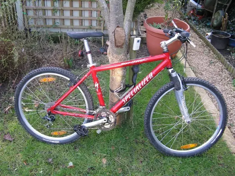

Sooo.. I'm gonna ask a potentially dumb question here... can I convert my bike from 7 to 8 or 9 speed? I appreciate it will mean new shifters etc... and new wheels.. but is the frame spacing the same?
Frame spacing is same, here's mine in its guise as work/pub bike with 8 speed transmission apart from 9 speed chainrings.
