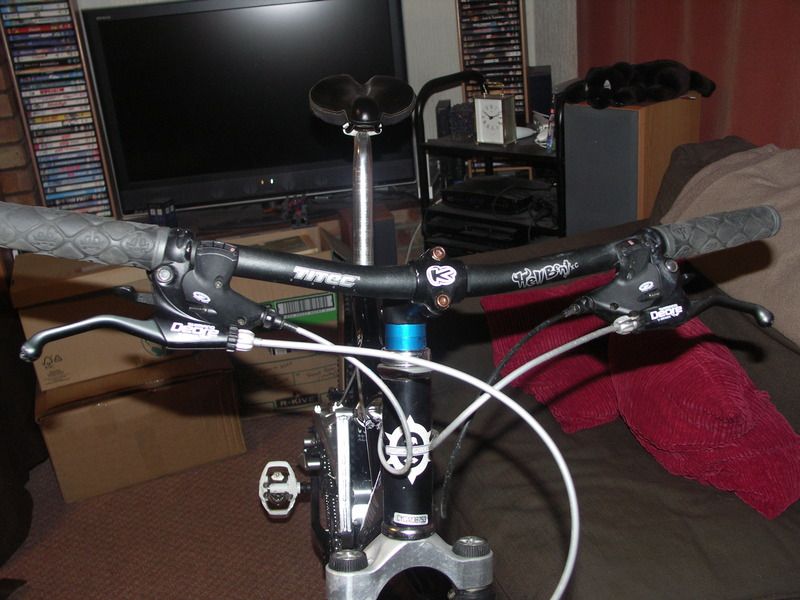

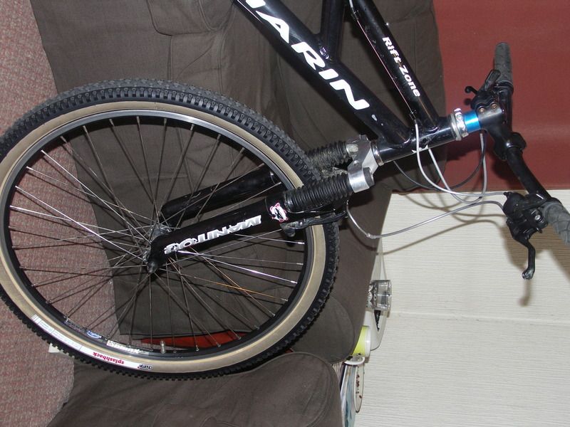

Here it is:
Here's the current spec:

Handlebar: Titec Hellbent
Grips:WTB
Barends:None
Brakes:Shimano Deore V brakes
Brake Pads:Clarke
Brake Cables:No clue
Cantilever cable hangers:Nope
Brake Levers:Shimano Deore combined STI 9 Sp.

Rims:Rigida Sphinx ( Nope, nor me )
Hubs:Dawes Soakomatic self flooding H2O and Salt absorbers.
Nipples: It has some, yes.
Spokes: Shiny straight gauge

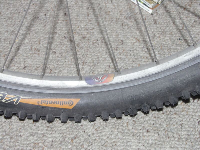

Tyres: It now has a set of Splashbacks but came with a pair of Conti Traffics which were as much use as a politician on a polygraph.

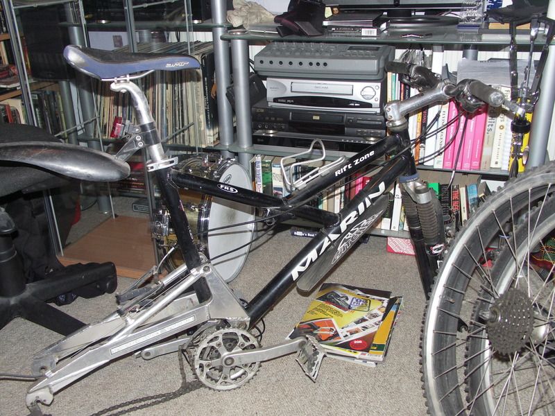

Here's the donor bike:

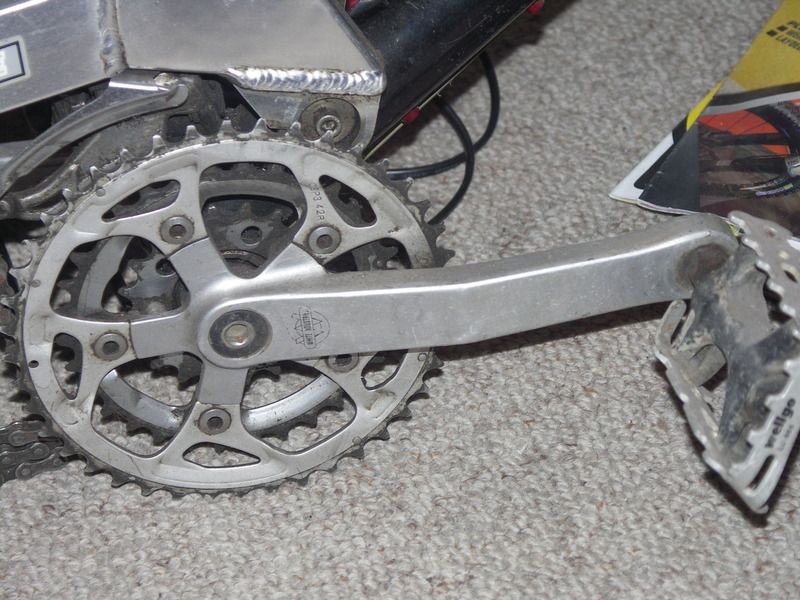

Chainset:

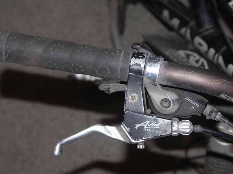

Levers/shifters ( on an Orange bar! )

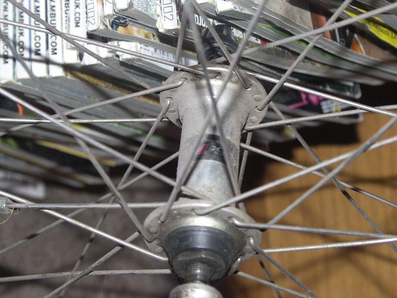

Front hub and rim

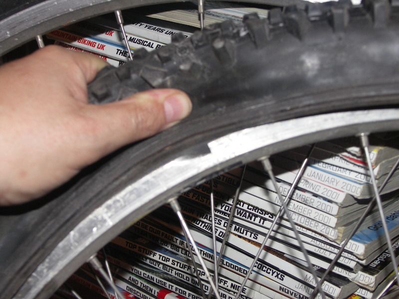

And...er the rear rim. The previous owner's dad did this while trying to fit the tyre. I don't think he used the correct, tools, but I could be wrong:
It's a Mavic X 1
Here's what's going back on:
White industries Chainset ( Sugino, but branded White )
Front wheel : STX RC on WTB rim
Rear Wheel: LX on ( if I can find one a WTB rim)
Tyres : I'll swap the new Splashbacks on to it.
brakes and levers.
New Girder stem - I will be repainting this so pics when that gets done.
Answer DH bar.
I am undecided which fork to use: the one already on it has been stripped and serviced by me, I shall do the same to the "new" one and see which is best, if either.
I am undecided whether to keep it 9 speed and put on new shifters or go full period and keep it 8 at the back.
I will probably keep the more recent rear mech as it's still period ( just ) but is in better condition than the original 97LX on the donor.

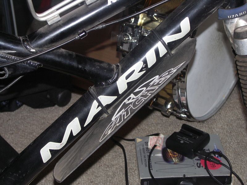

Oh and check the Crud Catcher installation:
Elegant. :shock: ( He's wrapped the bands around the front mech cable... :facepalm: )
