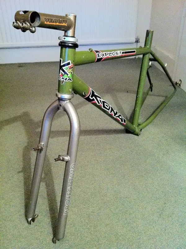

A few months later and I'm finaly getting this (re)build started! Below is a photo of the frame, mated with some TB P2s, control centre headset and velocity stem. (Apologies for the poor picture quality!)
I'm currently having difficulty with a seatpost related issue - the previous owner had fitted a 26.8 mm post and, as a result, the upper end of the seat tube has been over tightened to the extent that a 27.0 post won't fit without lots of grease and, er, elbow grease. Furthermore, rust and general crud which has built up further down the seat tube makes things even more difficult once the post has been forced in a few inches. Fitting an old post in this manner left it very scratched and has deterred me from attempting to insert my nice new ControlTech 27.0 unit. So my question to those with more experience than I is: would you attempt to widen the upper end of the seat tube to its original diameter and ream out the rest, or just be happy with the snug fitting 26.8 unit which came with the bike?
Thanks in advance for any thoughts!
Cheers,
Matthew
