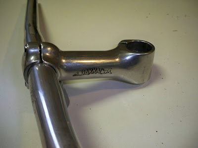

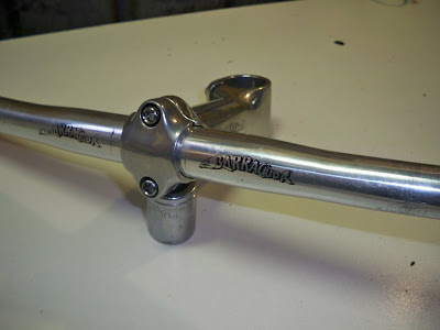

Found a NOS Barracuda branded stem to match the bars. I was thinking of polishing them but didn’t want to remove the logos and they would look a little strange with them being polished all except for where the logos are.

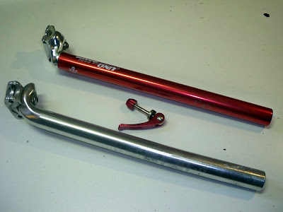

In keeping with my intended colour scheme the original kalloy will be replaced with a red one. Got this one cheaply from eBay, not quite sure whether to remove the white Uno branded and leave it all red, any suggestions? Also is a red quick release will probably change this along the way.

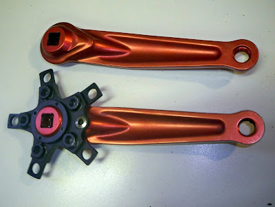

Next to the cranks. Found some red Cook Brothers racing F’s(I think). Not scratched, tapers & threads are excellent rust has a bit of ankle rub. Would look at getting them re anodised red and then sand blasting the logo back on but there not too bad & I want to give them a go as is.

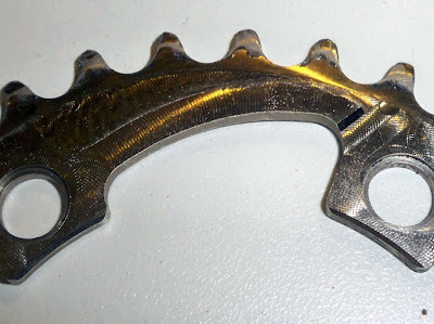

Cranks came with these 'Real" branded chain rings & I think they are quite a piece of art. Machined front & back, including the ramps, from a solid billet. Not in too bad a shape, so I will be using these

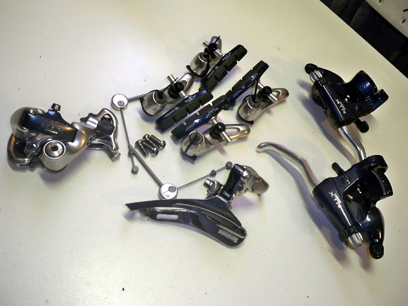

Now on to the groupset. M900 of course what else.

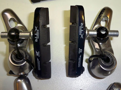

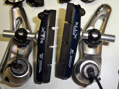

Picked up a set of shifters and cantilever brakes that had been fitted to a display bike and never used. The only mark is on the callipers from the clamps for the pads. Th rear mech was on the bike , shows some signs of use and the front came from here.

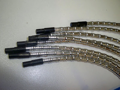

Have also received the cables. Decided to go with he Swiss comp here.

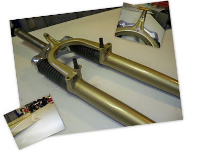

Last thing done - the Mag 21's. Stripped & repainted. Didn't completely strip them as there were no marks on the stanchion's and I don't have the tools to do the job propely. When I received them they were still full of clean oil and hold air.
