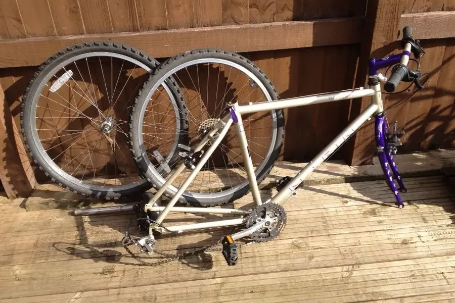

Busy few hours and much use of youtube but it's in bits!!

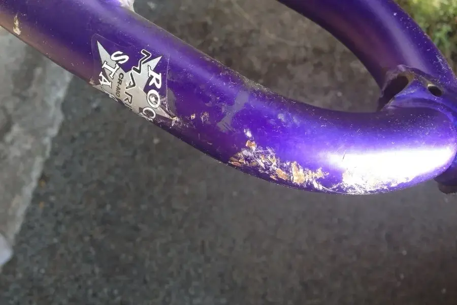

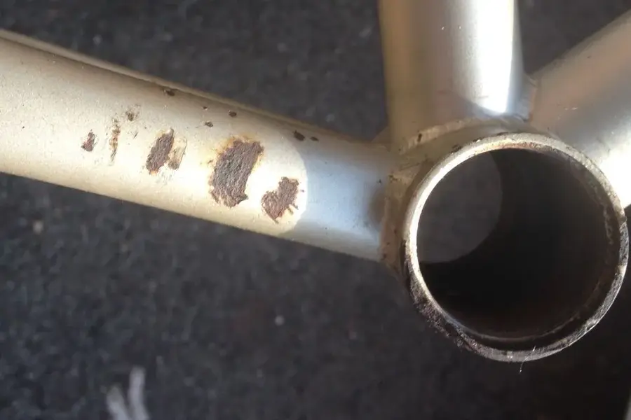

Known faults pre purchase.....frame, forks and stem scratched and a bit rough in places (see pics), tyres were shot, no front mech, awful gripshift and brake levers rusty spokes, one dodgy canti arm and a strange arm chair type sprung saddle(?)
Tonights Suprises......stem is 1 1/8", tooth broken on front chainset, seatpost goes and up and down!!
But.............
All good though, i have brakes, cables, chainset and cranks, front and rear mech, tyres, wheels, bars, grips, shifters & levers and pedals
So the plan is to get the frame and forks powder coated all same colour to keep costs down maybe the stem as well unless i can find someone who wants to swap a purple stem and champagne marin lite bars for something silver. Source a headset (possibly grey), find a saddle that dosn't weigh more than the bike and get shut of the purple seat clamp. Slap some decals on and off we go.
The wheels will clean up ok with much effort so they can be a long term project.

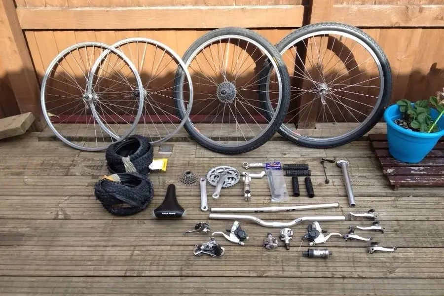

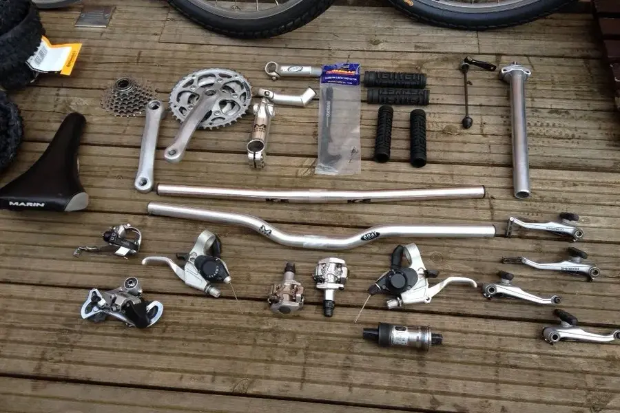

Bits gathered to date, waiting for a few odds and sods but pretty much there
Not sure which bars to go for flat or riser
Colour wise for frame and forks stuck! Silver cranks, brakes, bars, stem and seatpost but black headset......suggestions welcome!! All one colour to keep costs down.
Managed to get two matching rear cassettes so with two sets of rims should be able to have road and off road set ups
