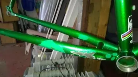

Rust is not too bad, a few little spots - and the majority of the frame is a bit scuffed...but the chain stays are looking chipped up. If I keep I will get it resprayed, but to get it going again any suggestions. I may go for the short term bodge of dark green hammerite, which looks like what the previous owner used!

Super cool - love that colour. Some clear nail varnish over those marks will keep it safe but not look too bad, or go for Hammerite again, but it needs protecting if you're going to get it mucky.

Its coming together - nasty green hammerite on the stays - but that's better than the rust!

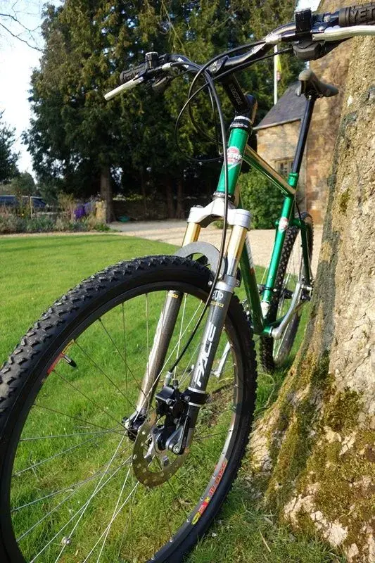

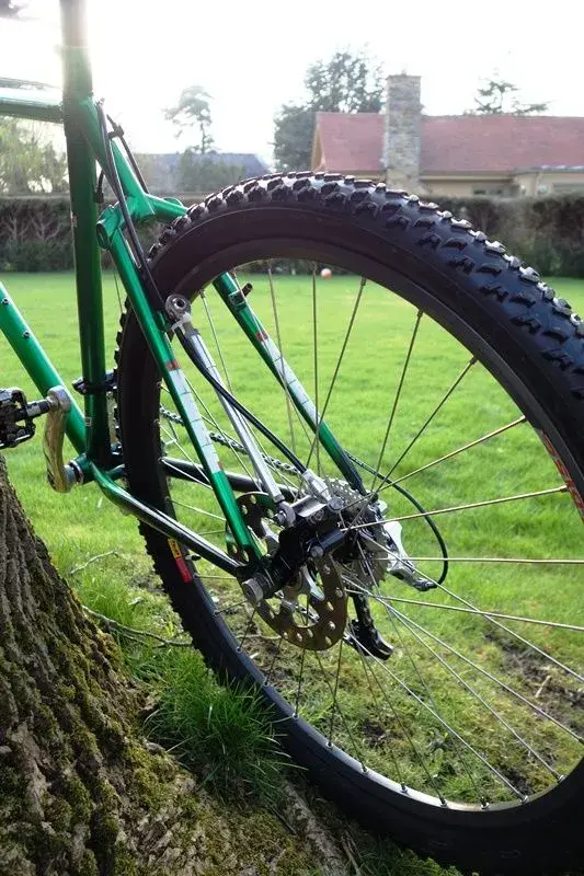

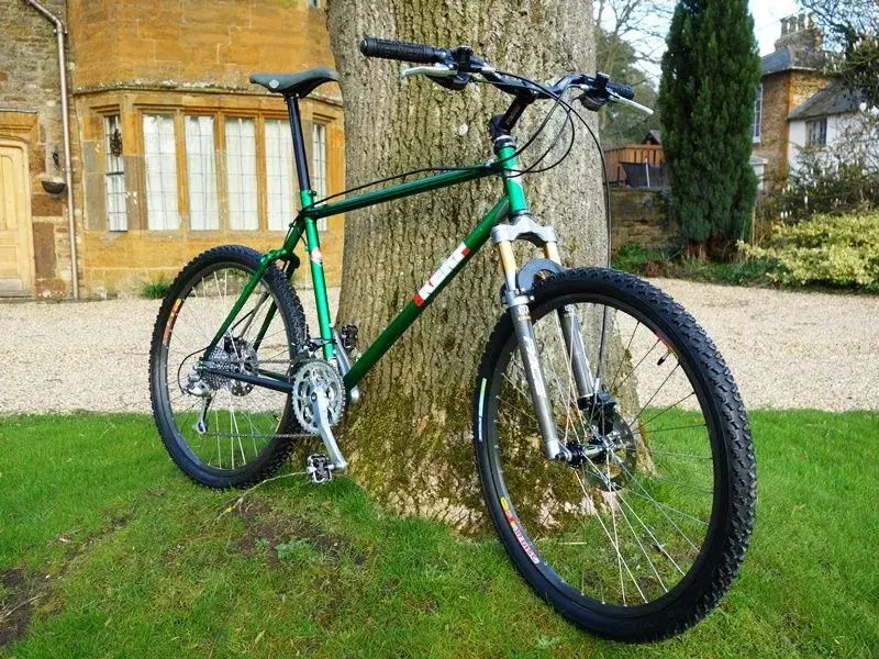

Ok - phase 1 complete.
Thanks to this website I have managed to source the bits and pieces I needed to get the Dekerf ride-able again. Plus found all the info needed to get the various bits working properly. It didn't need much, just a bottom bracket, headset, shifters, jockey wheels and chain.
Have stripped the fork and rebuilt it and put on new decals. Dealt with some rust and damage to chain stays (with hammerite so not the most professional of jobs!) Found new dust seals for the brakes (which need to be bled still)
Wanted to share my rationale for this spec. I realize the bike is a '94 mountain, but the build is from '98. Basically exactly as I built it with bits back then when I bought the frame second hand. The bits came off my old Cannondale that my brother still has (and I want back) So while the parts are not truly from this date, they represent the point disk brakes arrived in '98. These are Hope DB101s (which became C2s) with the various adaptations hope made to fit them to a non disk brake ready frame and Pace fork. It is also set up as I used to ride it with risers and a high stem which I bought in '96 I think.
Hope to get it muddy on Sunday!
Then need to decide if it stays like this or gets sympathetically "hot rodded"
Cheers all...beauf

Colour is great but really struggling to find a good match for a touch up paint. Its the original Emerald Green. Emailed Dekerf and was pleased to get a reply from Chris...but he said they don't do one as its a three stage process.
Any ideas how I can get a reasonable match for chips etc.
