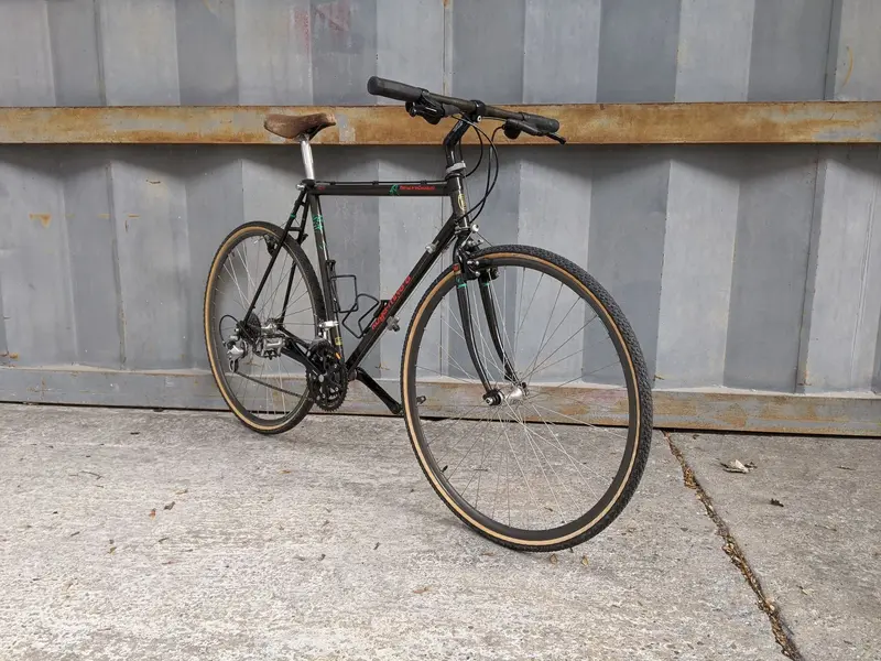

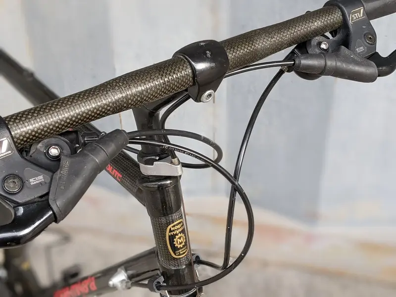

Guess the Road Section is the right place for it: I didn‘t want another bike :) , but sometimes I‘m having a look at classifieds, if there is a reasonable priced candidate for a hybrid to gravel conversion, and stumbled over this rare bird:
First owner bike and apart from the decals partially flaked off (worse on the non drive side), it seems in immaculate condition. Even the IRC Cross Country tires are still original spec.

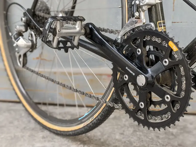

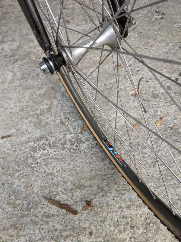

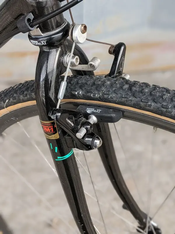

Some more detailled shots

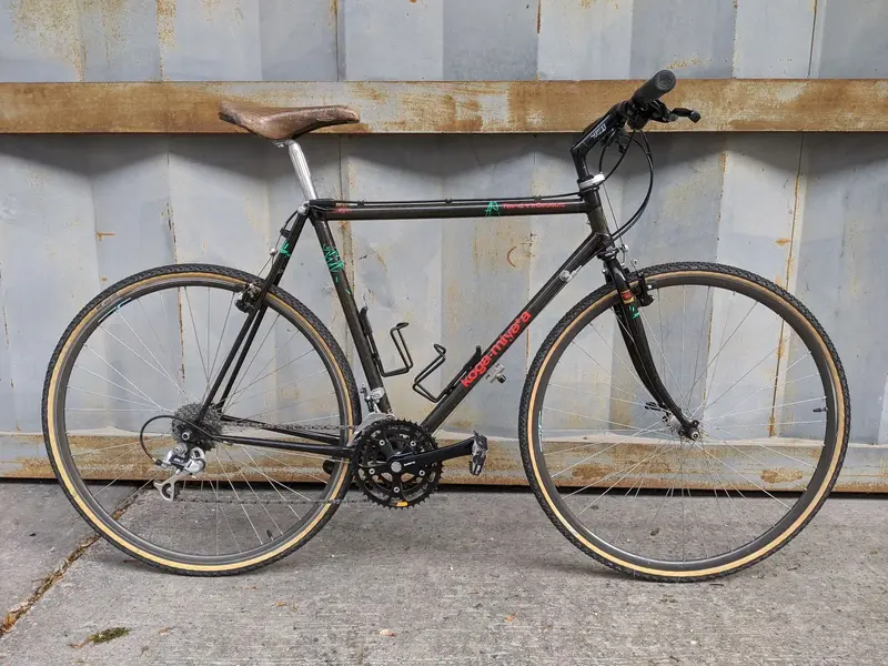

The seller had the drops replaced with flat bars right away when he bought it at Hans Lutz shop. He also replaced the seatpost with a Nuovo Super Record, as far as I can tell. I wonder why, maybe to save a few grams. I’m also wondering about the bars, which seem to be full carbon but will see after disassembly.
So far I’ve only cleaned it a little, flushed the shifters with WD-40 to make them work again, trued the wheels a bit and replaced two of the QR rubber O-Rings.
