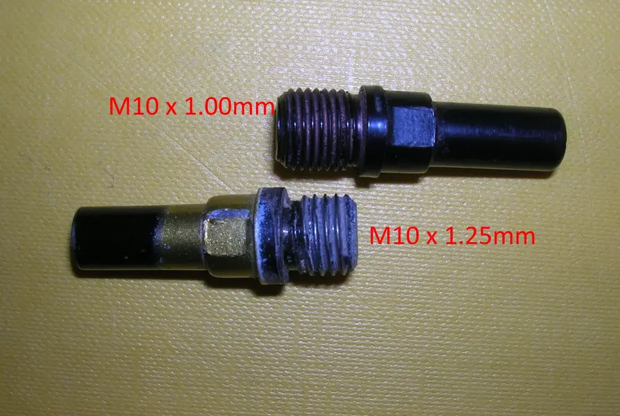

Hi folks,
Just wondering if anyone would happen to know the sizing for the brake bosses on a '91 Kona Hei Hei?
Cheers,
Mike

The later Hei Hei frames have a different pitch of M10 x 1.00mm, compared to the Steel and Aluminium frames, which are M10 x 1.25mm.
I assume that a '91 Hei Hei will the same finer pitch below:
Pip
