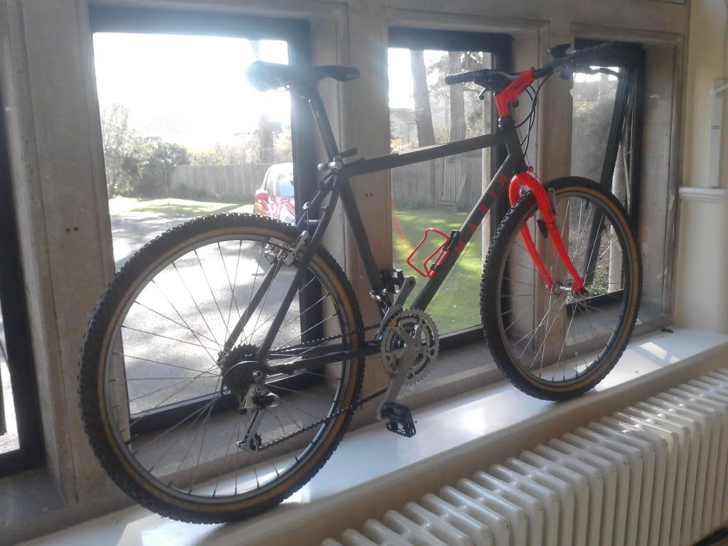

I've put risers on my '91 Eldridge and my '93 Palisades without any trouble. As long as you twist the bars as you fit them you should be ok.
The only thing to note is the reach of the stem, my palisades had a 150mm reach and i think it looked odd so i fitted a 130mm reach today and it looks ok.
