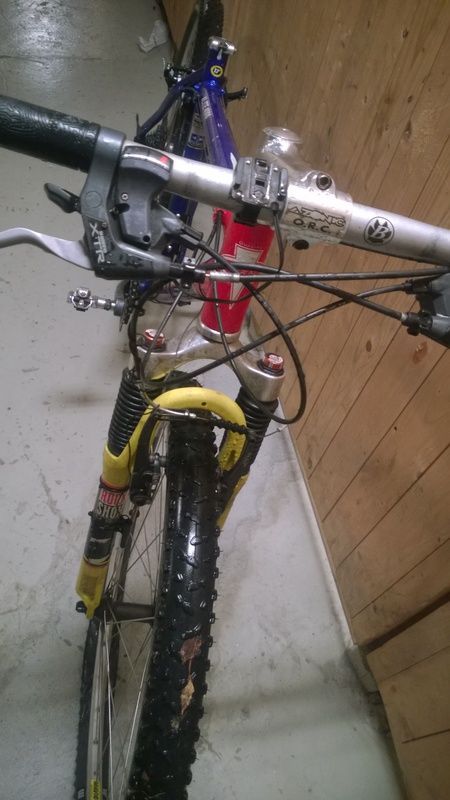

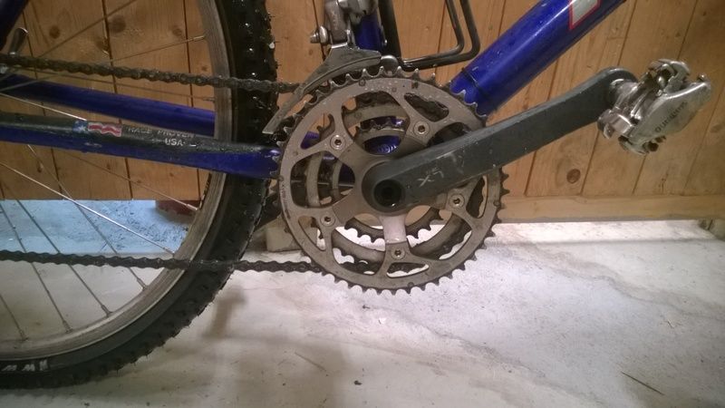

Found this 8 £ KHS Alite 4000 in the pile of thrashed bikes at todays westend fleamarket in Oslo. BB is shot. Will use the parts on a F 1000 Cannondale cad 3 frame. Anyone know if the 109 mm BB5500 Octalink will work on a Cannondale in Place of the 112,5 Xtr BB ?

With the 105 bb, the splines will be fine for the xtr crank as they should be octalink v1, the only thing to watch out for is the axle is slightly shorter so depending on your frame, clearance might be an issue.

BB disintegrated when I pulled it so I threw it out directly. Loose roller bearings and balls and wtf were Shimano thinking ?
