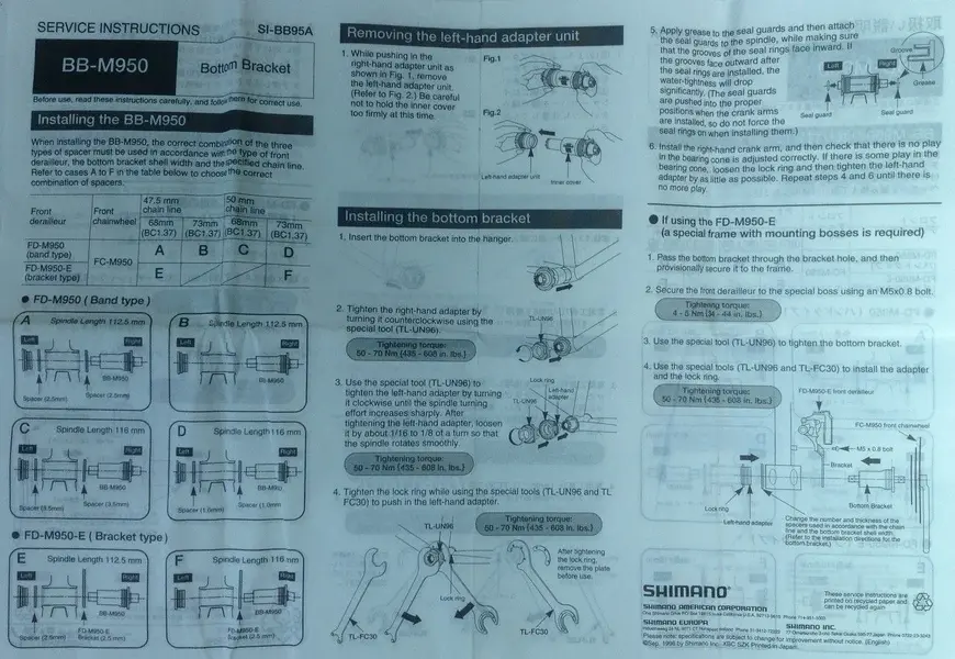

Can anyone tell me if I can use a 73mm (Octalink) BB with 68mm shell frame, with spacers?
I'm geeting the parts in for a bike I'll be doing up a bike at Easter which is currently in storage so I can't check the shell width. I thought that I could get a 73 to be on the safe side and just use spacers in case it's a 68 (would the ones that come with hollowtech II BB fit?)
Or is that a stupid idea? Cheers :)

Hello, are you talking about the Shimano BB-M950? If so: you can use it definitely for both 68mm and 73mm.

I'm looking for at V2 Octalink so not one of the old XTR ones (something like ES5x/ES7x). Interesting that the XTR ones seem to come with spacers to fit either but I've only ever see the others specified as 68 or 73?
I bought a NOS M950 Octalink BB and can confirm it came with spacers.
I fitted it to a 68mm frame using the spacers.

Thanks, that's what I gathered from the sheet above but I'm asking about the possibility of using spacers with the non-XTR Octalink models, which I don't think are intended to be used with them as far as I know?
Just picked up an es30 for £10 delivered 68x113. Problem solved cheaply.
