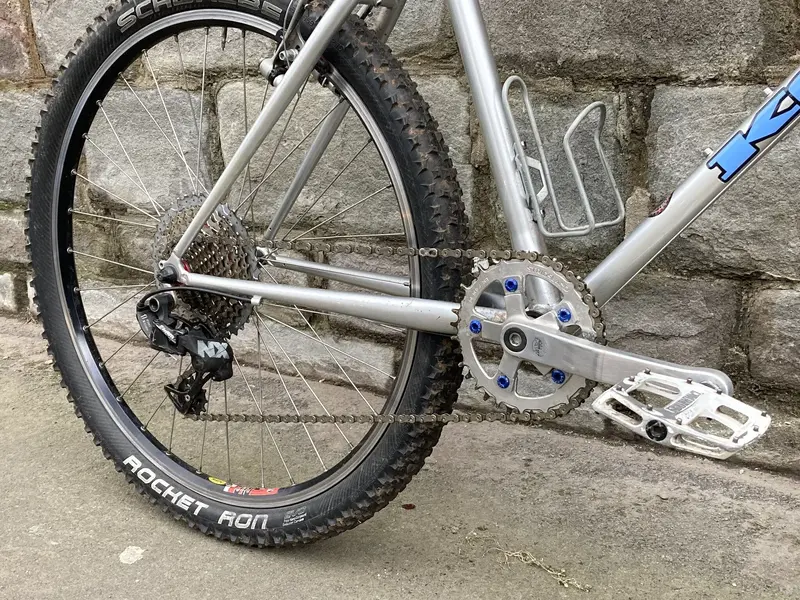

What chainrings are you using?
The chainring is a 34T Stridsland chainring, one of the only narrow wide options for 94bcd. Matias is based in Denmark, and is a cool guy. They're on the expensive side but I managed to find mine second hand!

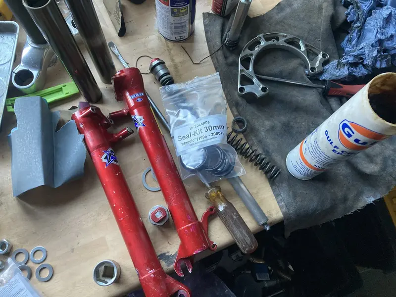

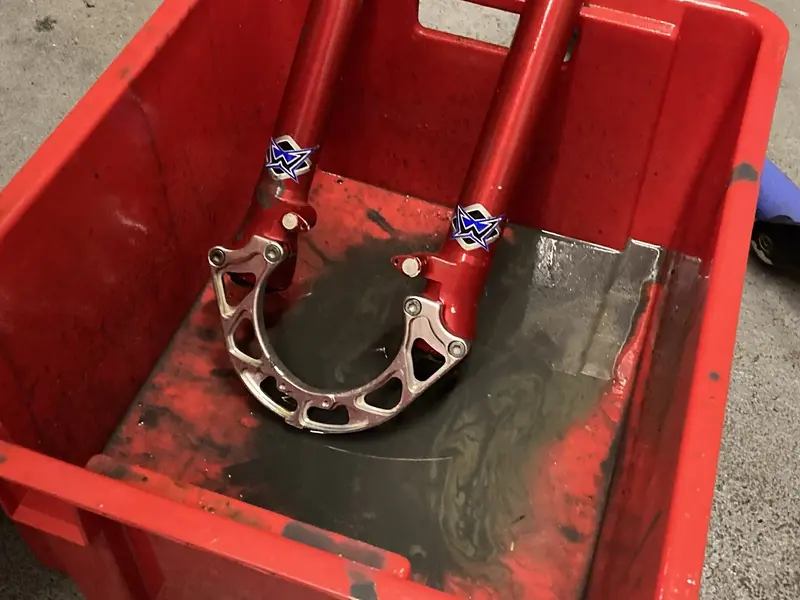

The forks should be good! I didn't ride them pre-service, which in hindsight would have been a good idea. I've only heard good things about them, the BAM is the lightest of the Z2 series I believe. It's also got 30mm less travel (and costs a lot less) than the Z1. I was concerned about altering the handling of the bike too much, so the 80mm travel should suit me nicely.

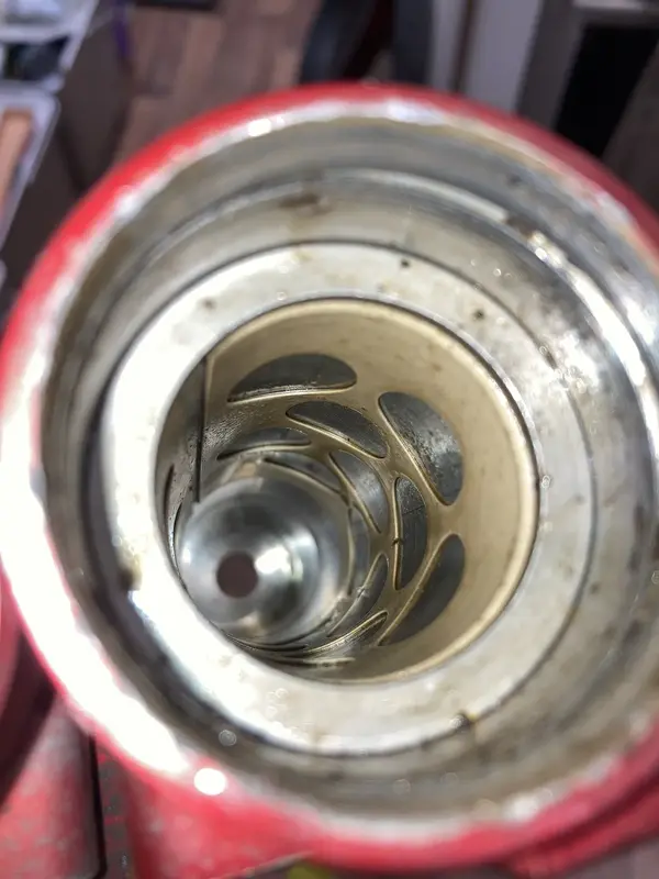

Me and my friend Ollie really struggled getting the seals out of the forks, looks like "7 years in the loft" (according to previous deceitful owner) hadn't done the rubber any favours. Heating the lowers in boiling water did the trick alongside a couple of hours of prying with a long screwdriver. Internals on one side seemed fine, but the other was very dirty! A bit of wear on the stanchion might be the culprit, but looking to remedy that with some nail polish.
Left side/right side
New seals from @kraeMit should be coming in the next few days, then it's a case of fitting and riding. Will update on progress!

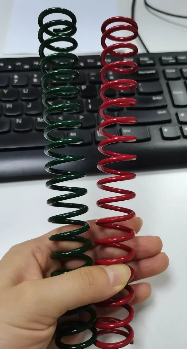

I have about 25 each Z1 & Z2 and have analysed the springs a little, because I'm in reproduction. From that parts I have I know the springs are different, some are stronger.
If you measure yours we might find a set which is more suitable for you.
Also for the Z1 I have collected all spring kits to be able to meassure.
I already made a test production of the Z1 100mm springs (check picture) and I think in Q1/2023 I will be able to do harder 100mm and some 130mm also which in the end means you might be simply cut a harder Z1 spring to get a harder Z2 spring. 🙏

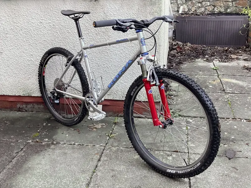

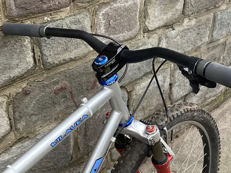

Fitted the seals from @kraeMit (great quality, great service) on Friday, and got the forks properly fitted and set up today. I think they look, ace! They feel fairly soft, I'm 75kg and can bottom them out easily, although with 80mm of travel I imagine this is normal. Anyone had experience adjusting preload and rebound on these forks? I've wound the adjusters all the way, both ways, and not really noticed much change. Red and blue ano seem to be in a good balance on the bike now.
These pics aren't great as the light balance was off in the yard, I'll get some better photos another time!

Standard Springs are somehow 'soft'.

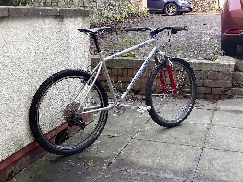

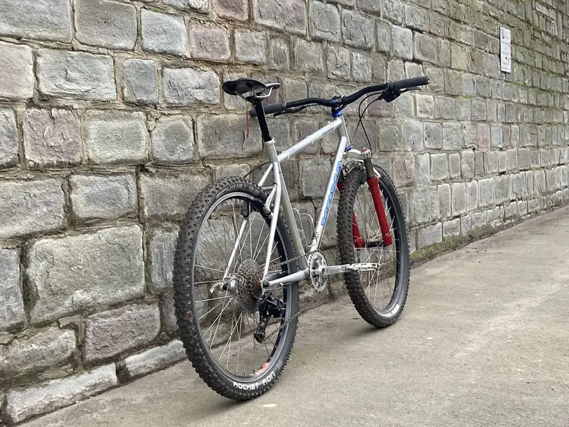

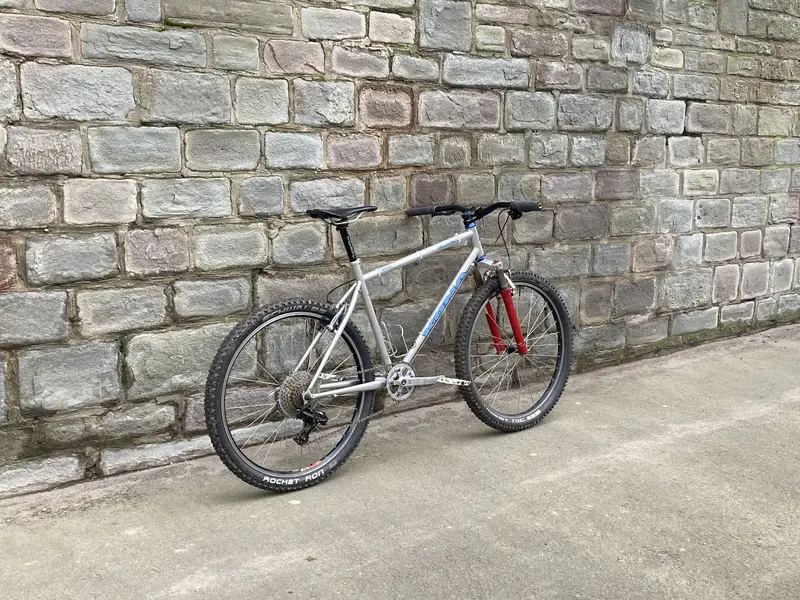

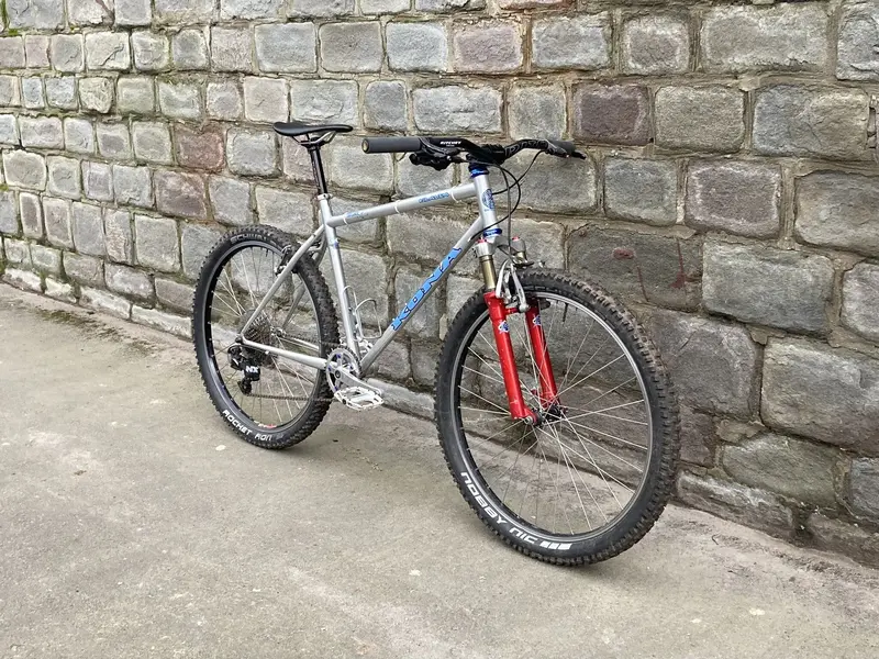

Updated photos in better lighting. Look at those anos clashing! Zip ties on top tube are to hold the full cable outer to the rear. I have some adhesive cable guides I could use instead but they hold the cable a bit loosely. So I’ll look for an alternative to tidy it up a little.

Hey, apologies for the late reply. Just seen your Cinder Cone thread and remembered your comment here! I've ridden it around the streets, down some steps, but not on anything too rough yet. I read somewhere that I'd misunderstood the adjustment on them, and they seem to have stiffened up a good amount after changing.
This is my first mountain bike, and my first set of sus forks, so I don't have a lot to go off. I'm probably not the best person to ask for a review! I'd say stick with the stock springs and see how you like them first. I can recommend Dr. Zocchi if you need any spares for the service!
