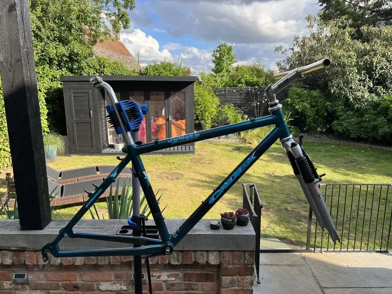

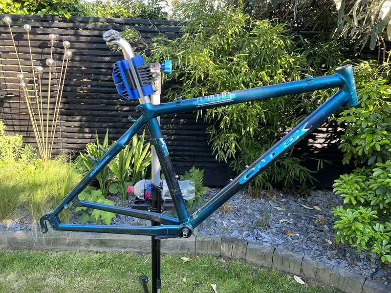

Here’s the newly acquired bike to build from
First thing to note is that it’s probably smaller than I had BITD as it measures c.15.5” ctc, but as I haven’t spotted one of these in years, I’ll take what I can get for now!
I’ve stripped the bike down to a bare frame (just need to extract the BB), and it’s fair to say it’s no garage queen, but when viewed from a distance it’s not bad!

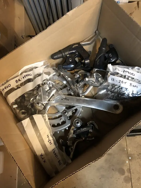

I’ve got most of the parts, some forks on the way, and an idea on what other bits I need. Just need to create some space in the garage to keep it and the time to build it as usual.
Thinking about this build and whether I should go down the M900 route as this is what I would have been running…or plump for an M910 groupset as it’s a ‘95 bike.

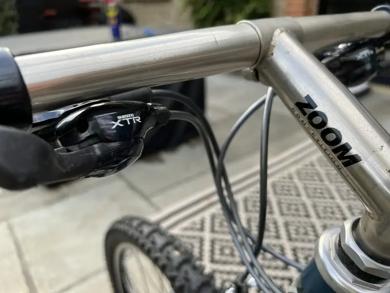

Zoom competition stem and Zoom 130 bars - both equivalent to those fitted to my KHS, and likely to be close to what was fitted BITD.

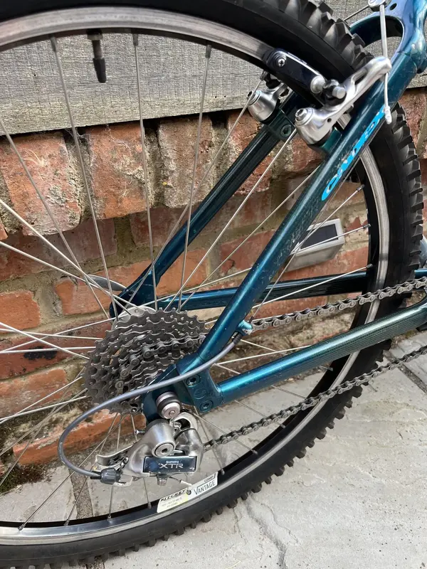

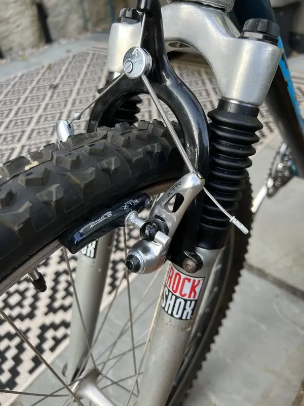

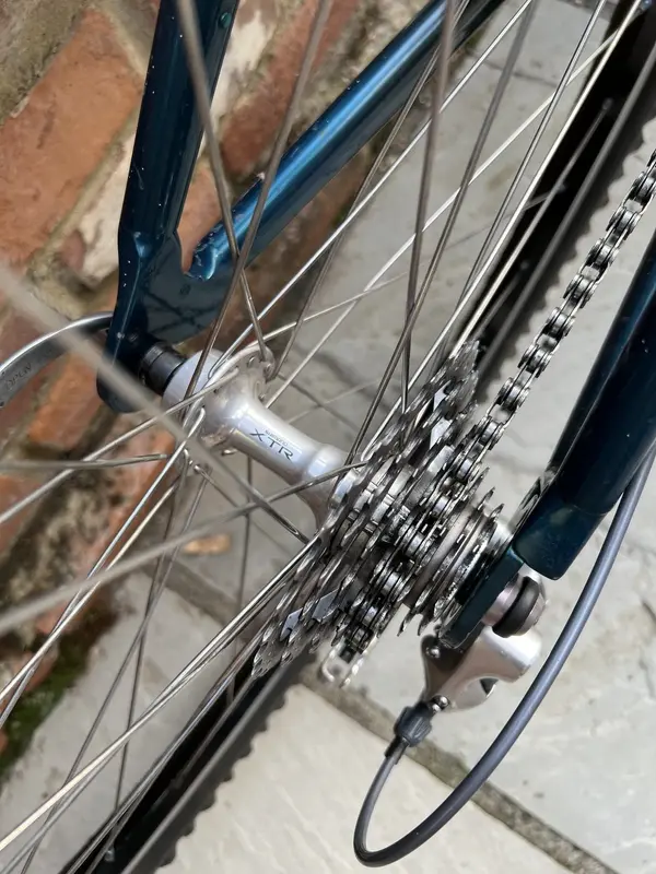

M900 XTR cranks, mechs, brifters, brakes, and XTR/Ritchey wheels with Michelin tyres.
So not much to do :)

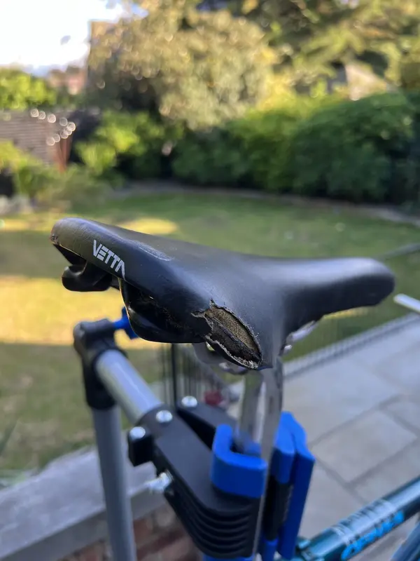

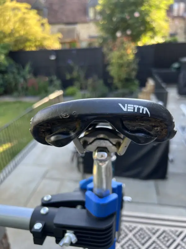

One other piece I added was this;
Why on earth would I add this shabby, slightly wonky and generally past its best saddle I hear you ask? Well the fact that it’s stamped ‘95, and has been in my spares box across multiple house moves over the last two decades, would suggest that this is THE saddle that the bike from BITD was fitted with, so it seems only right to fit it here :cool:

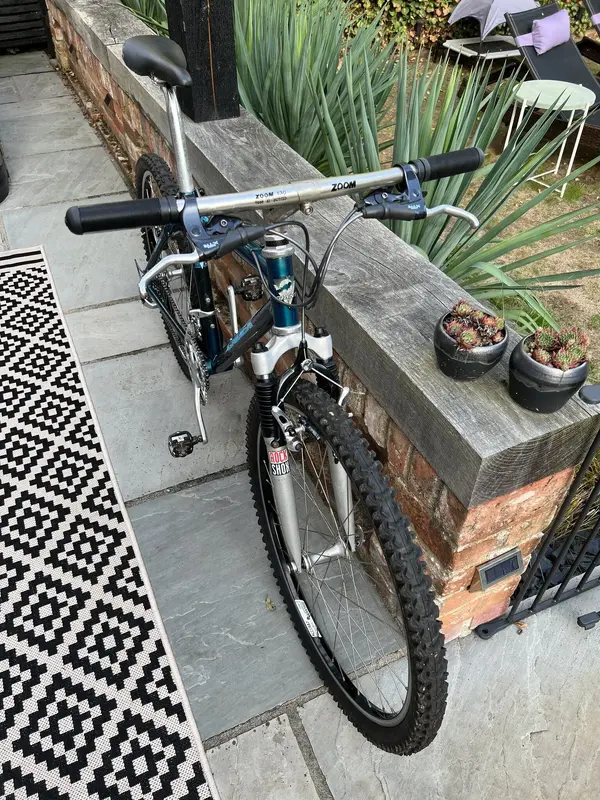

All cabled up ready for a final setting of the brakes and seat position before a test ride and some photos :cool:
My inventory suggests I have about a dozen pairs of grips in the spares draw, but of course none of them are the type I'd like for this bike - so a new pair has been ordered 😂 🤷‍♂️:rolleyes:
Turned out nicer than expected, but still very much ‘rider’ quality!

Brakes: Shimano M900 XTR
Brake Pads: Shimano M910 XTR
Brake Cables: Shimano XTR
Cantilever cable hangers: Shimano Type ‘A’
