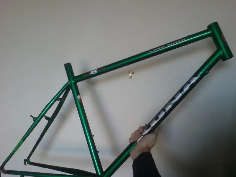

Have recently aquired a 1994 Lava Dome from ebay and am looking to rebuild the bike up for everyday riding (rather than a proper retro project). Pics:
The bike was advertised as an 18" but it actually measures 19" from centre of bb to top of seat tube - which is just as well as the seat post sticks out just enough to get my 5' 10" body onboard. The frame is in suprisngly good nick and certainly doesnt warrant a respray. The RH chainstay had carpet tape on which I thought maybe hiding some nasty damage, but on removal it looked good apart from a couple of chips. Just needs a good clean to get rid of residue from the tape etc. There seems to be a mix of original and non-original parts on the bike:

I'm looking to replace the forks, stem, bars and seat post with some modern stuff (probably go with riser bars and a shorter stem). Was wondering if you guys had any suggestions with what to go with. What options for forks do I have, and what diameter seat post will fit?

Well done! As you say, the frame looks good and it'll be superb for its age once it's cleaned and polished. And yes, it's a size 19.
The worst thing on the bike IMO is the wheels, as ever with Konas, and the biggest improvement you could make would to find some hand-built non-disc replacements - they feel better and you could probably save a pound in weight.
The bike is 'suspension adjusted' (but only just, 93s weren't!), but was designed for 50mm forks, so something like a 70mm Z2 would be ok, but I would suggest that an 80mm fork is on the outer limit. Obviously if you want a modern fork, your choice is a bit limited by that.
