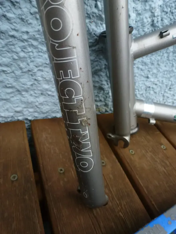

I'd like to keep the paint but there is a fair bit of rust and scratches. Might rub it down and clear coat but not sure how well it will apply over parts like the fork where the decals have been scratched and and are raised/peeling.

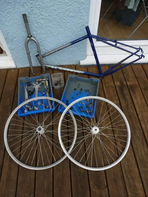

Yes, I wasn't going to look at it then realised it had the triple butted forks. It is all stripped down now and will investigate the wheel bearings.
Not my favourite job but very satisfying to have a bike worth of parts degreased.
Hubs were not too bad so think I'll just rebuild with new balls and use them. They were full of tar like thick sticky black grease.
Headset is just about re-useable although lower seal is perishing.
Not sure I want to buy a full set of chainrings so might end up 1x7 or SS.
